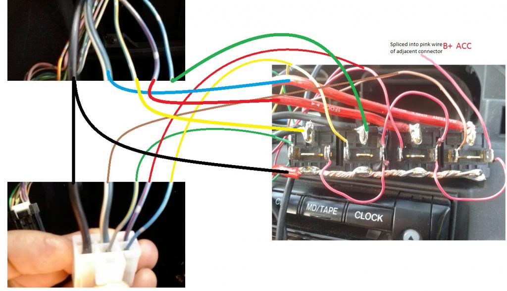

Here's a diagram that I made of my relays.. It might help you build one.
