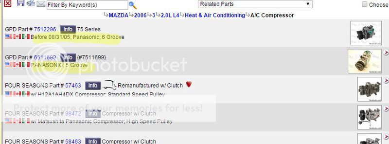

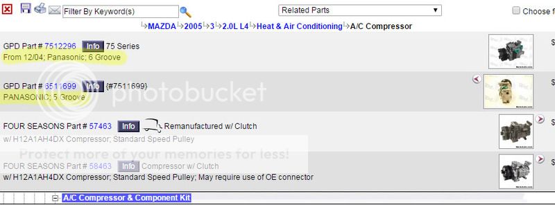

They both say that there's no difference between models from 2004-2009, with the exception of the speed pulley, which is apparently something that only applies to Mazda Speed Turbo models. But I read in another forum that people found the 4 Seasons compressors noisy, and preferred the ones from GPD, which was also available from RockAuto. Lo and behold, I found GPD compressors on their site, and there are 2 versions of them for the 2005 model year!
One says "PANASONIC; 5 Groove" and the other says "From 12/04; Panasonic; 6 Groove". The 6 groove one is actually about $30 cheaper, but my car was manufactured in 08/04, so it sounds like the 5 groove is the one I need.
I'm not sure what these "grooves" are that it is referring to, but at least they aknowledge that there is a difference! Its strange to me that this other seller seems to be saying that it doesn't matter... their compressors ARE cheaper, and I like knowing that this seller on ebay is selling the same 4 seasons part that RockAuto does, for nearly $80 cheaper! But I feel like I should lean more towards that other brand, the GPD one because they seem to be more in-line with what I've researched on the car.
