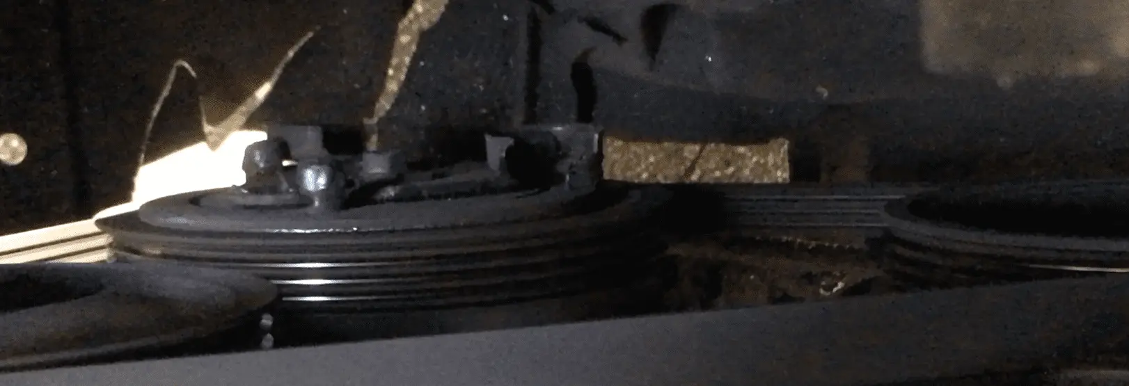

Guess I can't upload a short video on here. Here's a picture. You can tell how tore up it is.
With car off I put a screwdriver on Clutch to see if it turned freely. It did not.
It's rubs against the pulley. I can turn it but not easily free flowing.
I still am not sure where wire is.
Also when I first turned car on I heard a belt high pitched squealing sound.
After several starts after the high pitched squealing went away.

Is your compressor spinning ??
The clutch could be so damaged that it won't dissengage.

It looks like the Compressor Pulley is spinning but clutch is not and it shouldn't be.
Remember I took the fuses out, so AC won't come on. So clutch is not going to spin, correct?

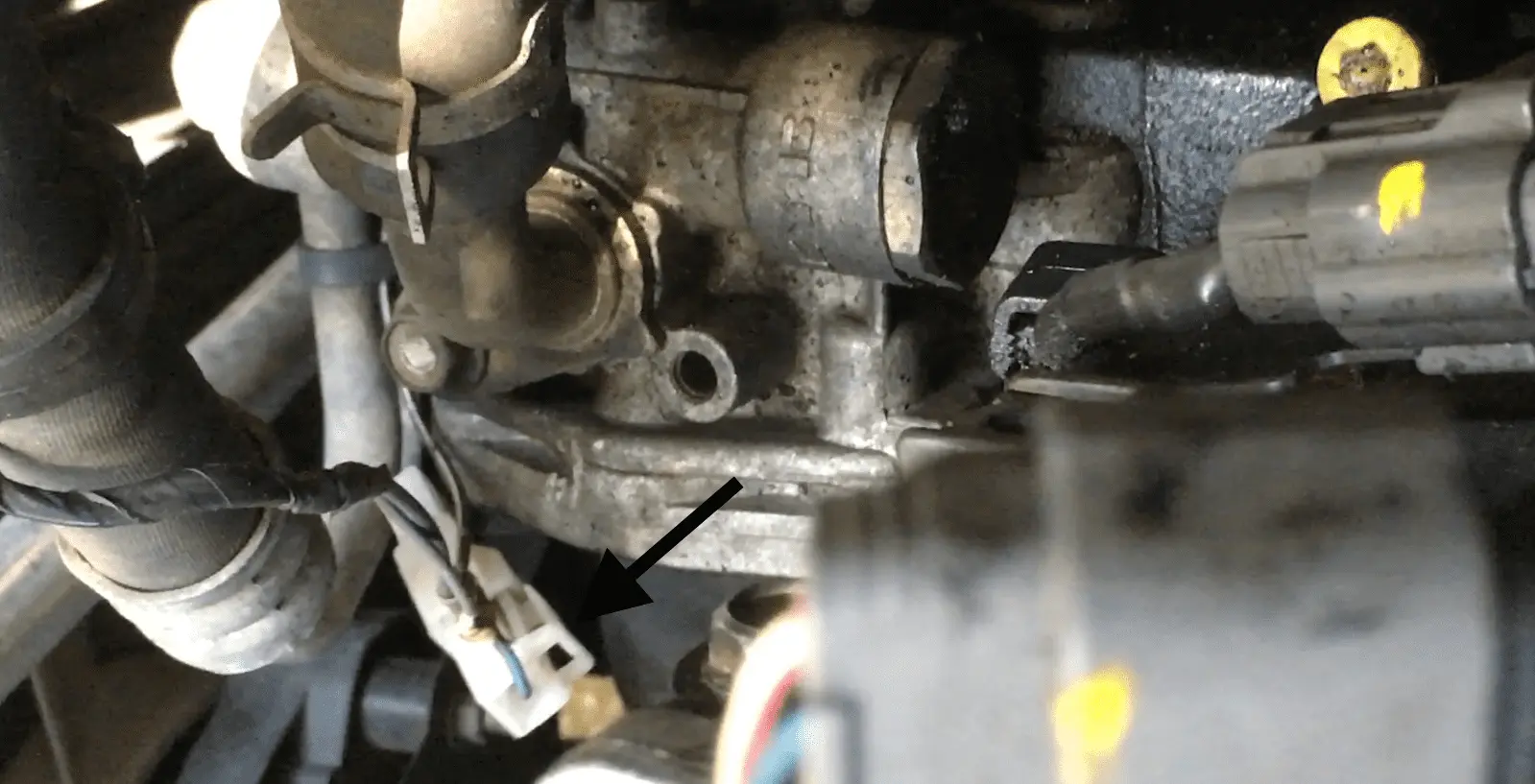

My question is where does the 3 in your diagram go to? Somewhere easily accessible when I open the hood? Like the picture I showed you.Where does that wire # 3 connect to?
So the wire goes from the compressor to the clutch? I thought it went from clutch to another place up in the car. ;-) That's why I asked you if that was the wire in that photo.
All I know is that the clutch is electrically operated.
If the wire to the clutch is disconnected it will not engage.
