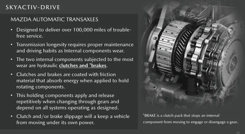

Mazda is a little funny about what service intervals are. These are two screenshots from some internal documents around the Skyactiv Drive.
The first shows the design life of the trans to be trouble free for 100,000 miles +
While highlighting that it requires proper maintenance as it ages.

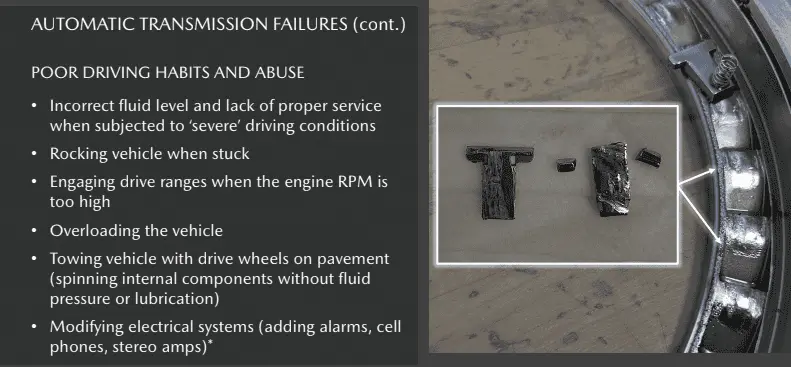

The second slide calls out failures specifically related to "lack of proper service when subjected to 'severe' driving conditions"
You'll be hard pressed to find any owners manual from any gen and market of the car that tells you what that is.
The first shows the design life of the trans to be trouble free for 100,000 miles +View attachment 327794
The second slide calls out failures specifically related to "lack of proper service when subjected to 'severe' driving conditions"View attachment 327795
"Modifying electrical Systems (Adding cell phones, alarms, stereo amps)"... that's an interesting one. I Imagine that interferes with the ECU in some manner?

We actually run into these issues on various OEMs all the time. Especially prevalent with Chrysler products and something plugged into the OBD2 port. Truck will work fine one day, the cheap reader they bought on Amazon fails and brings down the CAN network or will put you in limp mode. Anything that can tap into the 5V reference signal for can hurt a transmission.
