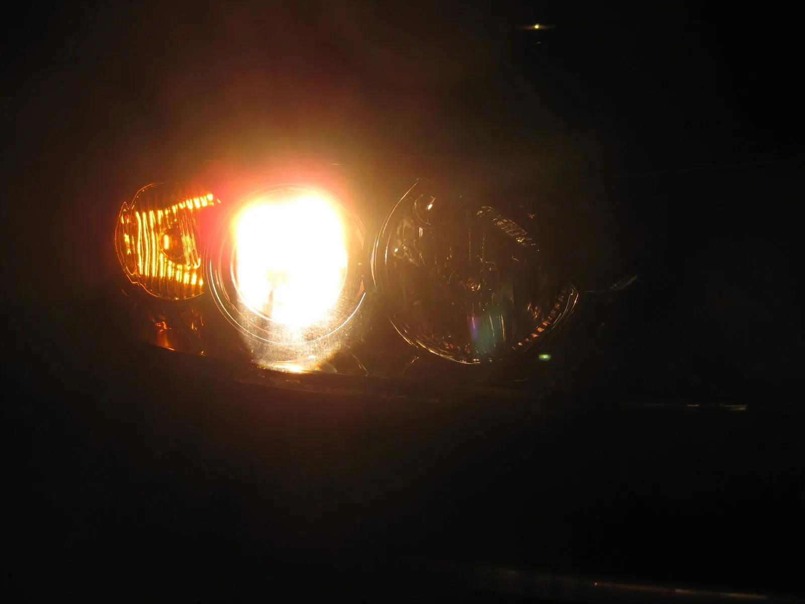

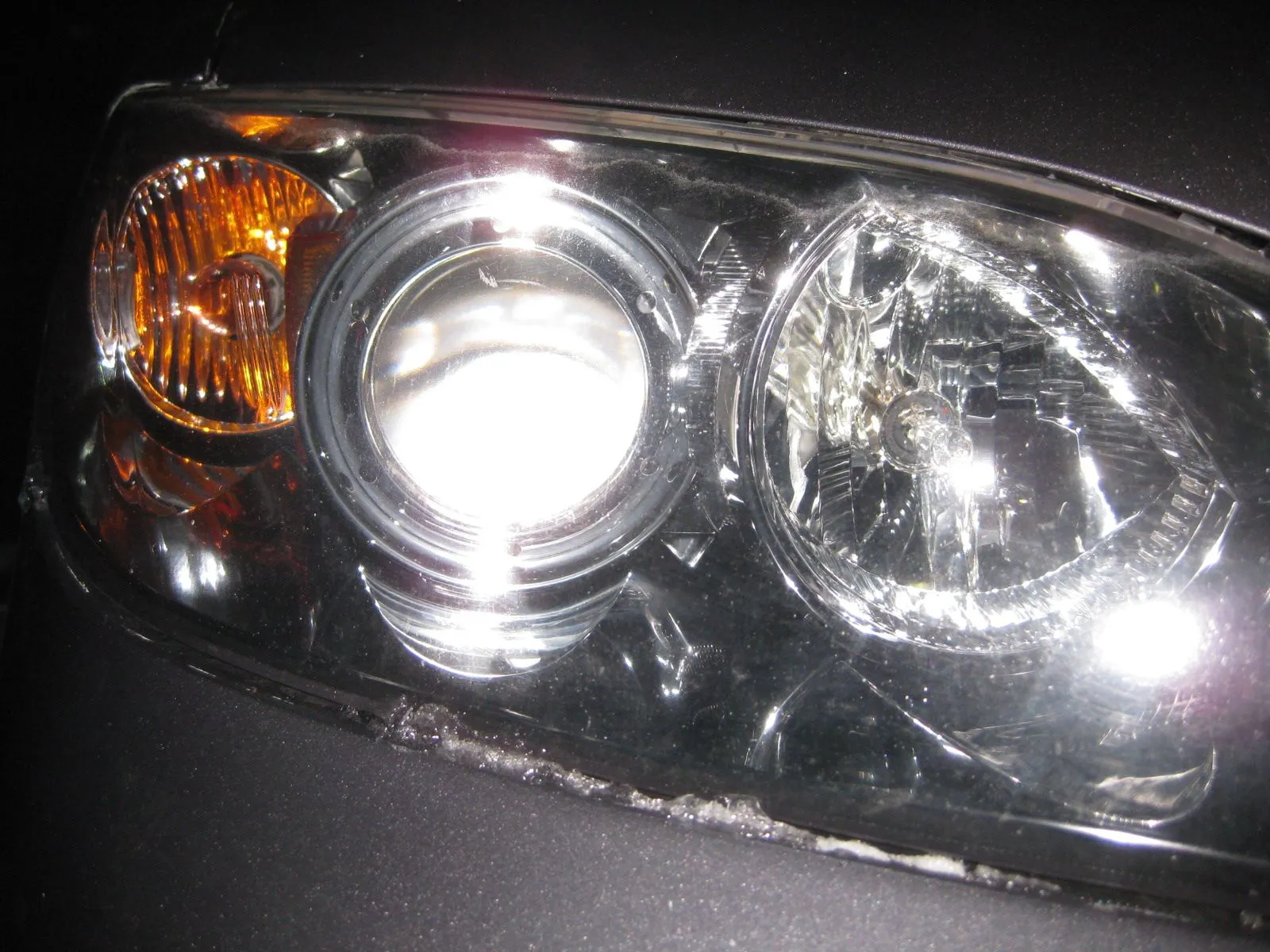

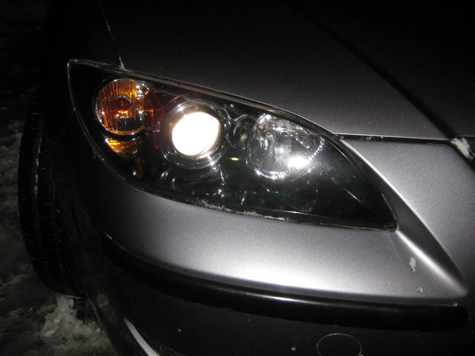

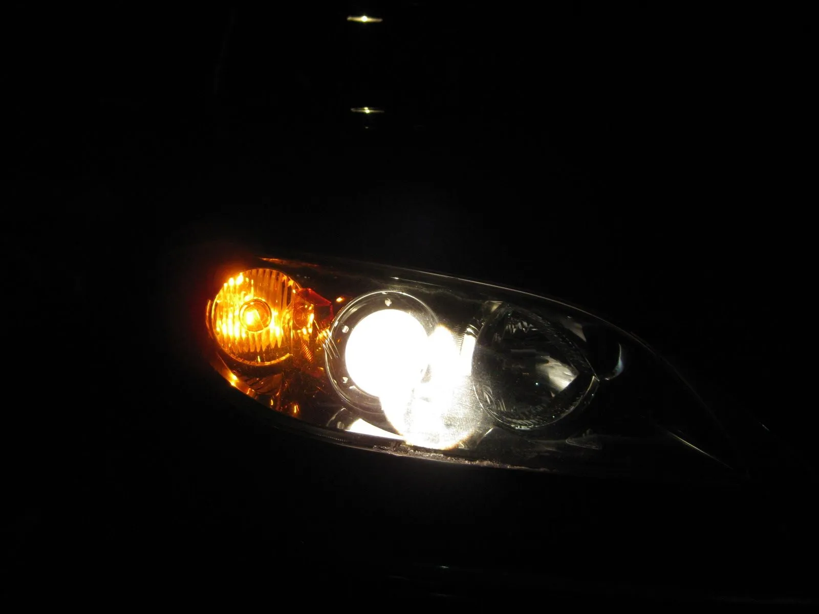

I didn't think my car came stock with HIDs, but my father says the foggy bubble shape is HID, so I would like some clear answers from the people who know best. here are some pics. the first two are unlit, the second two are lit.
thanks,
Mike

just cause it's "foggy bubble shape" doesn't mean it's HID....that's just the type of housing for the headlights. if you have the 2.0 I model, you don't have HID's. the housings will be the same, the difference is in the bulb/ballast.
Are there any wires going to the bulb? Or you can try and see if you can locate ballasts for the HID bulbs in each side of the headlight.
That's a standard 3 projector light like on my wife's GT.
Your dad is mixing up "projector" which is the style of light housing all these cars have, with HID, which is basically a type of flourescent bulb. HIDs require a ballast, which will be mounted near the light and the entire internals of the light housing are different for the changed light focus of the HID bulb. DO NOT get sucked into buying Ebay "HID retrofit" bulbs for your car. All you'll do is spray light everywhere and blind oncoming traffic. Buy a decent, high output***not high wattage*** halogen bulb (like Sylvania Silverstar) for your non-HID car and be happy.

You can rule out factory HIDs because Mazda does not offer them on the 2.0 3i model.
As for aftermarket you can either look around for wiring plugged in to the stock harness going to a ballast (little box) and then to the lamp, or you can pull the lamp out of the housing and look at it. Bear in mind this will probably result in a lot of swearing as you play with the retention clip. lol If the lamp has a filament in it then it's halogen. Simple as that.
As to how high the lights are that's a simple matter to fix by adjusting the aiming bolts on the back of the housing. I believe (off the top of my head) that it's a 10mm adjustment bolt. There are three on the back of the lamp. The one to the outside adjusts side to side, and the one on the top is the main vertical adjustment. You can also use the bottom one to adjust the height, but if you're only moving it a bit then the top one should be fine. Just make sure to mark where they are now and don't adjust them too high.... a little goes a long way with headlights.
