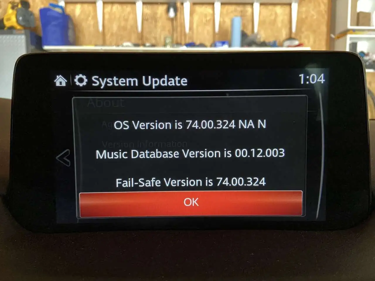

Just FYI, for anyone wanting to update to latest infotainment version.
Just updated mine, it took about 28 minutes total (I was on 74.00.230 w/ Music Database version 00.096.000). This update also updated the music database to 00.12.003 (which just means more album art is available).
Unfortunately, I wont be providing links to the FW (took me less than a minute to figure out the link using google).
It is noticeably faster. I also notice that if I use Siri or any text-to-speech function, it now routinely (properly) goes back to SiriusXM (or whatever source I was listening to prior).
With my .230 and prior, using text-to-speech anything would inadvertently leave the Mazda infotainment in phone mode.
While some of my previous updates where just "meh", this one does seem worth it (in my opinion!).
