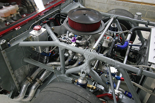

The car that originally put this plan into my head: http://onelapcamaro.com/
sub a dub dub to see how this goes, the Chevelle is one of my favorite cars and seeing one rebuilt/repurposed to race on a track is pretty damned cool
Oh look a Summit catalog showed up just in time for my flight today. Guess I'll use the time to figure out an engine plan. Leaning towards the big block plan now. I'd like to get at least 650 lb-ft of torque out of it. I'd still like to attach a 6-speed to it though so I can get decent gearing for the street and still have enough top end for Daytona (probably hit about 150-160 with this car there).
That set-up looks similar to NASCAR suspension. I wish I could remember where we bought our used parts from back in the day.

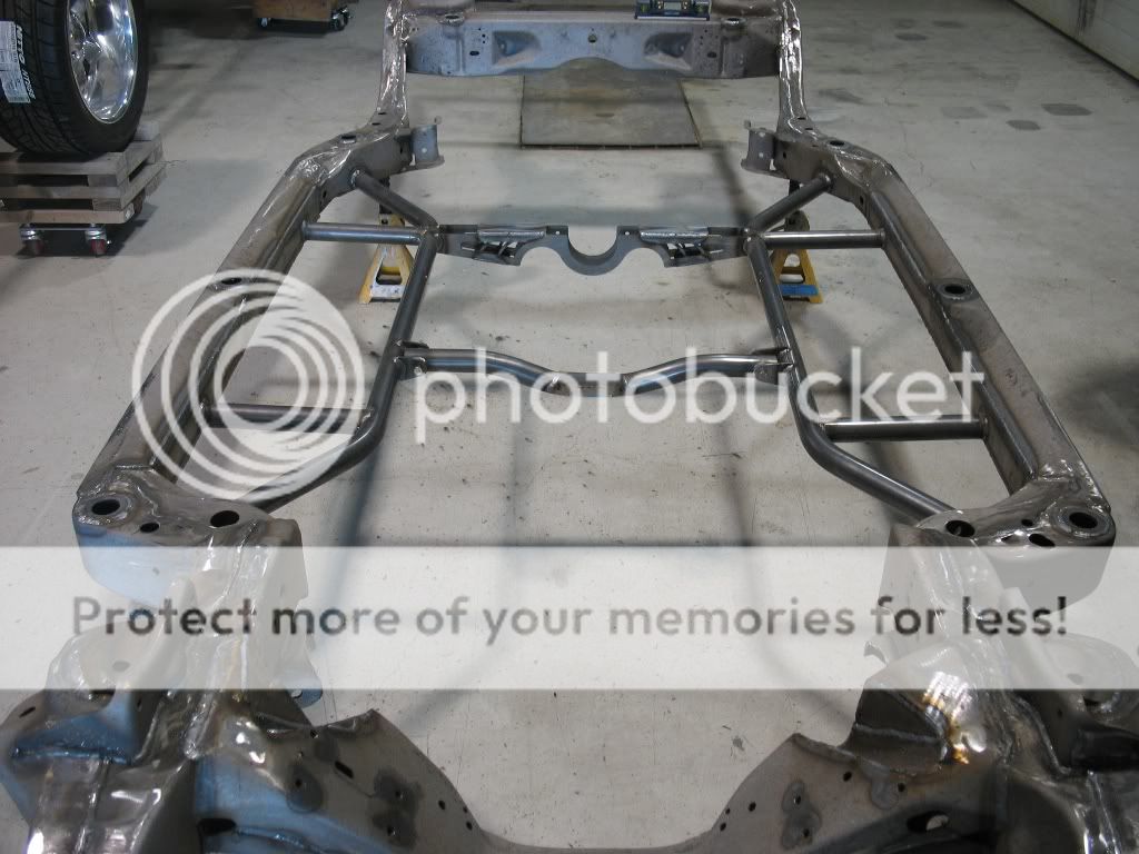

So I'm not able to cut up the frame to modify suspension mounting points. Damn. So I'll have to get the modified geometry control arms, taller spindles and find a shock that fits in the stock location. This will limit how low I can run the car. But at least I can have unlimited chassis stiffening (allowed in the roll cage rule as an exception to the above limitation) so I will still have a pretty nice platform to build from.
Something like this as a base:
Then a full roll cage on top of it with the body attached as well for added stiffness. I plan on starting out in TT3/ST3 so I am limited to an adjusted weight to power ration of 9:1. I think my best option will be somewhere in the neighborhood of 3200 lbs (with driver) and 370 wheel horsepower and 275 Hoosiers all around (tire size goes into the calculation for adjusted weight/power).
