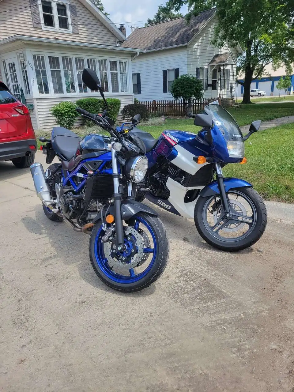

In the warmer months I am on my Suzuki Sv-600 :)

And yea, Conrad...I ride my bike all summer any chance I get. Put 1,000 miles on it in 3 years...and I'm 2 miles from work. Sometimes take the long way home on that thing, too. :)

It is an option and I probably could, but the motorcycles are way too fun! Actually thats an old pic, I sold that '93 EX-500 and only have the '19 SV600 now.
It's mandatory to take the scenic route on the motorcycle! And even when I'm hard on the acceleration at every opportunity, im still easily getting 40+ mpg. It's a shame I cant ride 4+ months every year.
