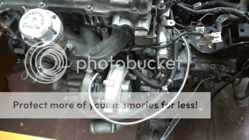

also, picking up my brand new gt2871r from my buddy tonight. trying to get it running this weekend.
gt2871R with a .64 exhaust outlet, and thats the 3 bolt outlett from a sr20, got a hell of a deal on the whole set up from one of my drift buddies, brand new with a bunch of other stuff for 800!
its a t25 flange, 5 bolt gt downpipe flange. pretty much stock replacement for msp as far as bolt patterns and everything goes.

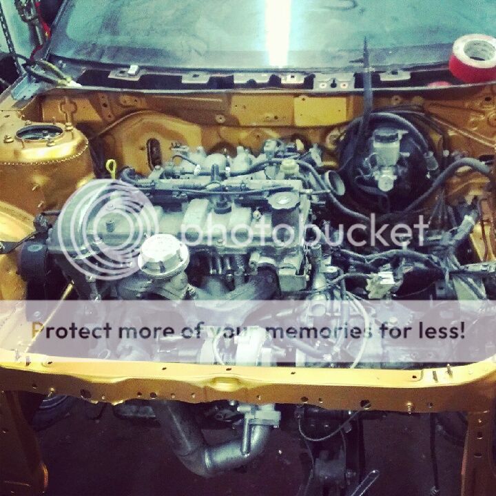

got everything together, running, and looking pretty. only to find out that the differential has seemed to have fallen apart... cant get another till next friday :( so stoked to get it runing though
there were 2 problems. 3 of the wires going to the coil packs wer severed, and there was a kinked fuel line...
Luckily, i was able to get the car back together and running, only to put it in gear and find out the differentials spider gears seem to have fallen apart.... ugh. new trans this weekend then it should actually be on the road again.
