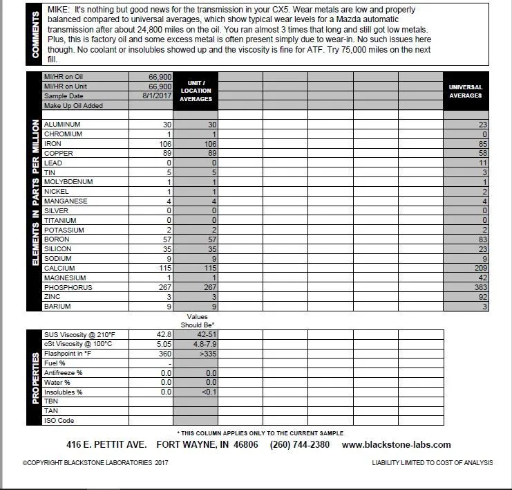

After researching whether I should drain and fill the ATF and seeing there was no consensus, I drained and filled mine at 66,900 miles and paid for a Blackstone analysis because I was just so curious with Mazda saying you never need to replace the fluid and other saying 30-40,000 miles. I did buy the vehicle at about 65,000 miles but the previous owner said he didn't remember draining the ATF and wouldn't have done it unless it was part of the scheduled maintenance, which it isn't so I believe this is the original fluid. Blackstone says the fluid is all good and they'd try 75,000 miles but I don't know what the actual numbers mean so comments are welcome! For what it;s worth, this is a 2014 Touring.

Thanks for posting this. It's pretty much what I would have expected!
The main thing to note is the flash point, and viscosity at operating temperature. I really wish we had TBN on it.
Truth is, we don't know what wear metal amounts are "normal" for the CX5's transmission, as it's a different operating beast. You wouldn't expect normal metals from a CVT, no? So why this?
Anyway, it looks like the fluid itself is holding up extremely well, and I feel very vindicated by my decision NOT to have the fluid changed at any point.
I am not sure but does ATF have a TBN measurement? I know motor oil does.
This is a good idea getting this report. I wish we had a virgin analysis of the same fluid to compare to. I would be curious about the iron numbers in particular.
Overall, it shows the fluid is capable of extended service as Mazda intended.
