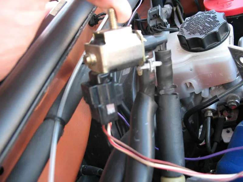

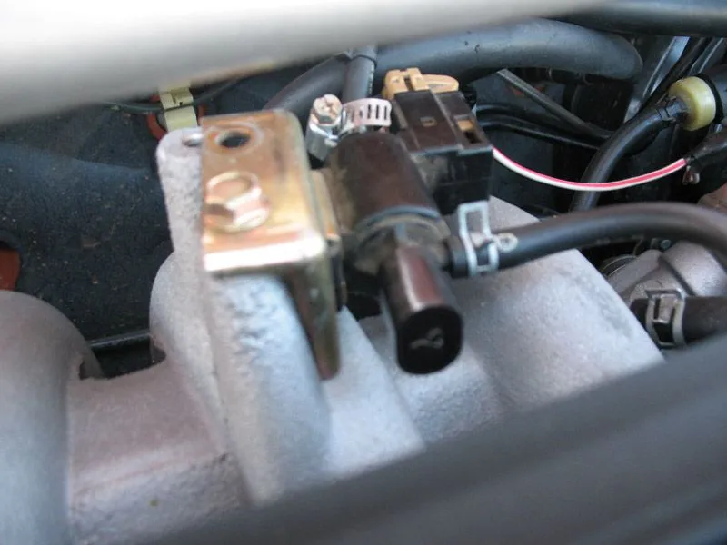

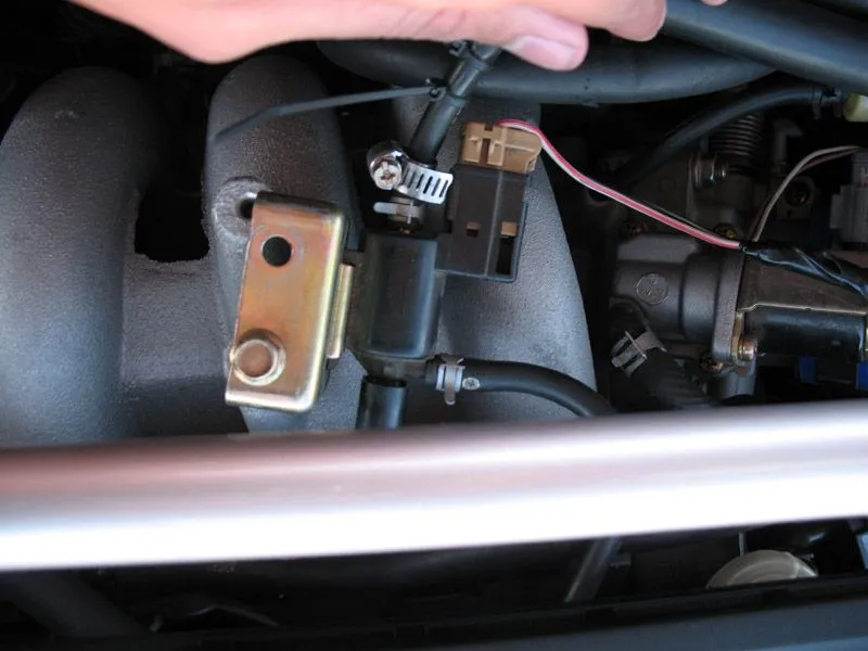

Alright heres the pictures. The first two are of the solenoid I was talking about in the previous posts. The 3rd is a picture of another solenoid that I have no idea if I need or not, or what it is.

yes those are the solenoids for the flaps/butterflies in your stock intake
the car will run without them...but you will get a CEL
i ran my PG manifold with and without them when i was hunting down an unrelated problem
you instaled it just fine
connect them and leave them withut vaccums conencted to them
that's the way i'm running mine without CEL;s

DO NOT disconnect that VSV on top of the intake mani. I have my car in the shop getting rdy for auto-x and saw what this goes to. It is important as it is the fuel presure VSV. It runs directly to the fuel presure regulator on the fuel rail. The two solenoids next to each other at the back of the stock mani can be removed those are the VICS and VTCS VSVs. Just plug them in and run them into the dead space between the manifold resevoir and runners where no body can see them. This way your CEL will stay off

That's what I thought, too. The one end goes to the fuel rail area. I would hate to see what would happen if you removed that guy. Boost + no extra fuel pressure = way lean probably.

Are you talking about the one that is bolted down? That one has two vaccum hoses coming off it and one of them has nothing to connect to.....Either way I left both of them plugged in. I guess Ill try reconnecting the vics and vtcs ones tomorow and see if my cel goes away.
that one with the bracket on it controlls the fuel presure regulator. one vac line goes to the intake manifold the other goes to the regulator on the fuel rail
Hmmmm. Ill go out and look at it today.
