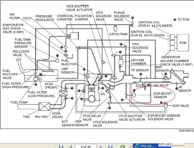

i ust found this:
http://protege5.ugly.net/01-40b.PDF
check on page 2 item number 11 by the firewall passenger side.
it is labeled as: EGR Boost Sensor on a p5 but as we know it doens't change for the mazdaspeed
check atatchement...
wouldn't a "boost sensor" be a MAP sensor....just another name?
If you were to look up the "boost control solenoid" part # it should just be a vacuum line.
