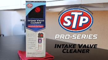

The "Fuel Induction" service they're suggesting might be worth considering. You can do it yourself, using a good-quality GDI Intake Valve Cleaner product. STP, CRC, Berryman. Can do at home, DIY for about ~$35 for the chemical plus your time.

STP GDI/Valve cleaner:
