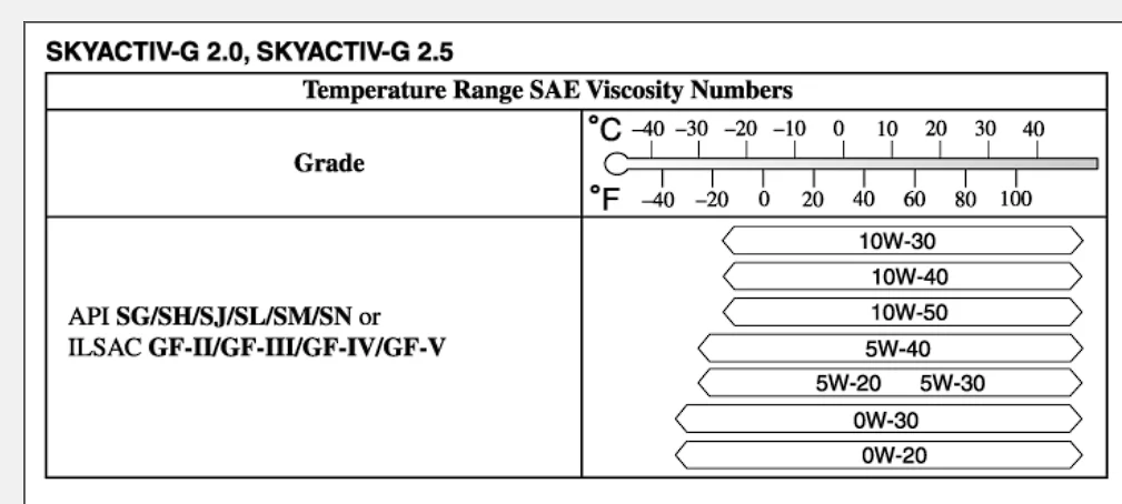

Ok - I'll bite. Scroll down in the file attached in this post and you will find:
This is for a 2.0 CX-30. I don't care enough to find the specs for the 2.5L, but I'm sure it's the same.
So, no, this engine was not "designed around 5w30." It was designed for a wide range of oils (0W20-10W50).

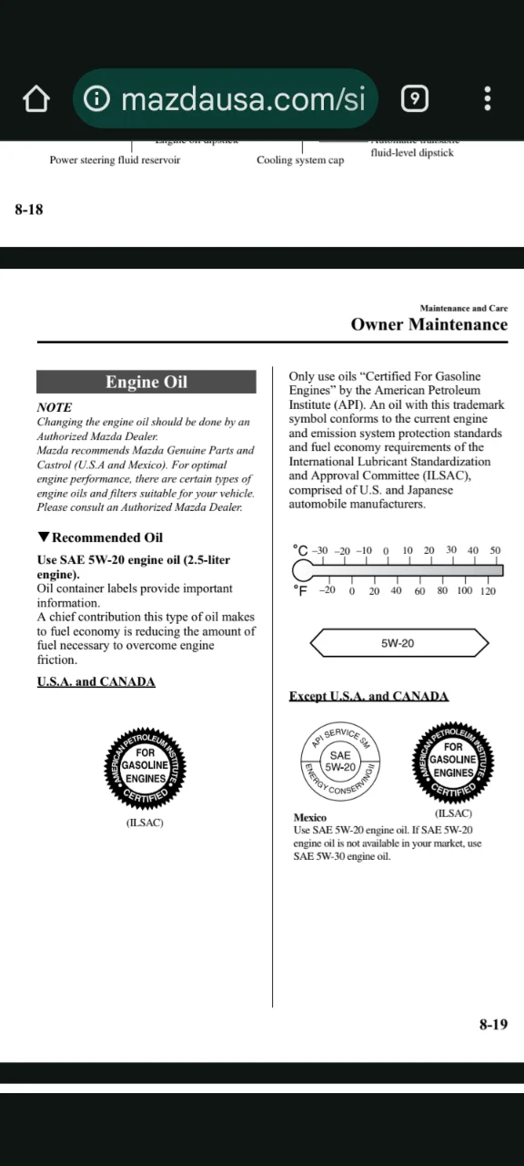

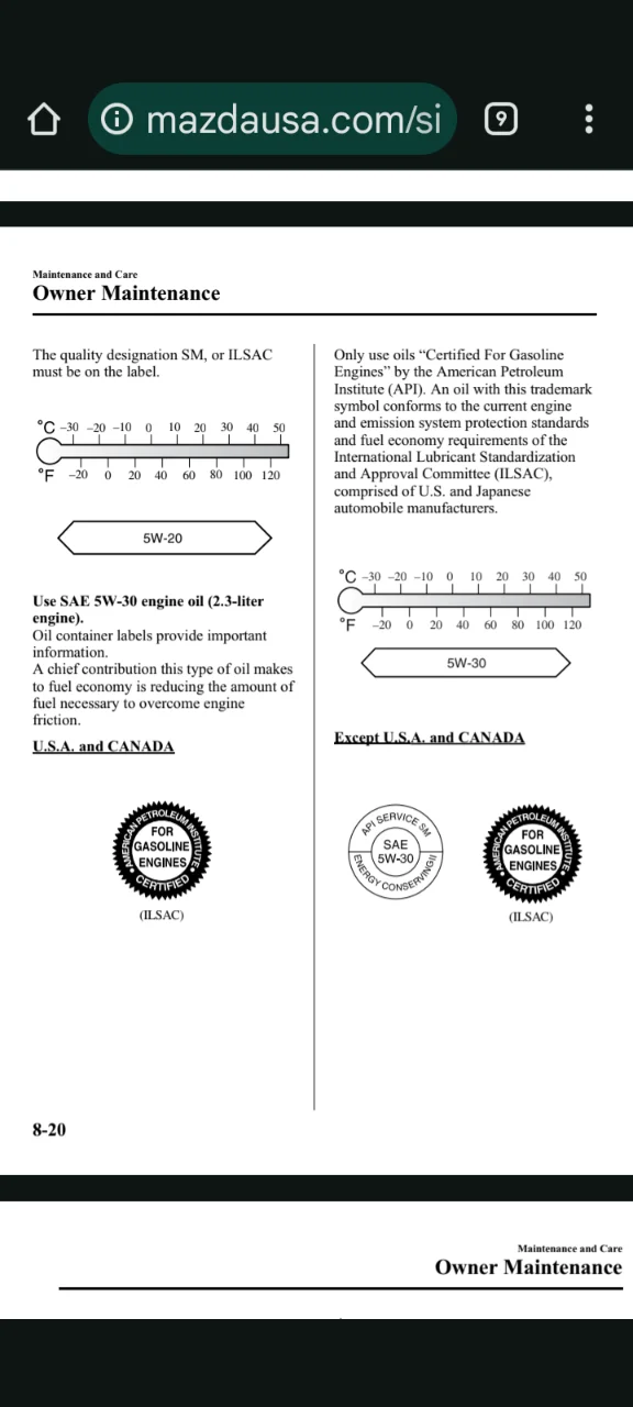

The OP has a 2010 CX-7 2.5. The owner's manual says use 5w20 for the 2.5 ltr engine, and 5w30 for the 2.3 ltr engine. If 5w20 is not available for the 2.5 ltr engine, then 5w30 is ok.

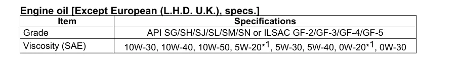

In this link, it is confirmed that the 2.5L also is good for up to 10W50:
I strongly believe it is nonsense that all of these weights, including 0W20 are suitable for well beyond 40c.

Bizarre that they would put that in the Mazda 6 manual for Australia and New Zealand.
In the CX-5 manual, the way they split out the countries is:
U.S.A., Canada
Except U.S.A., Canada
