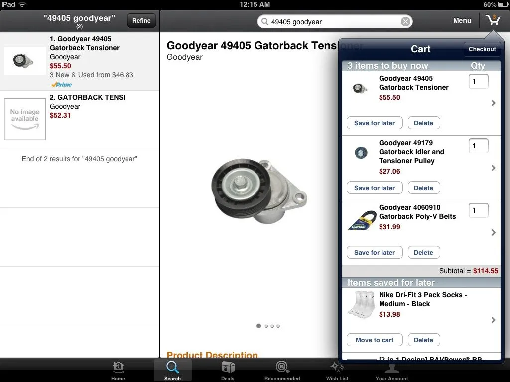

Well it's done, got about 500 miles on and so much smoother! Feels quicker also...But now that engine is so smooth and quiet I seem to have a bad idler pulley or belt tensioner. I know these are ez to change on our cars but what brand you guys use as I'm out of power train warranty.
I looked on rock auto and was thinking of going
Goodyear belt tensioner and idler with gator back belt but the part numbers are odd and I'm reading more people seem to use the gates belt tensioner. Other then brake fluid bleed this is last step before 6,000 mile road trip so I kinda gotta do it. By the way, sounds like you left a tool in engine bay, inconsistent but always at cold startup! I used stethoscope and its def coming from tensioner area. There's a vid on here some where's with it. Amazing how much smoother engine is when timing belt is tight, feels like a BMW six compared to before and I have corksport mounts!
Any recommendations?
. . . I'm reading more people seem to use the gates belt tensioner.
. . . Any recommendations?
Yes, get the Gates tensioner part. Should be able to get it at any "brick and mortar" local auto parts store. I don't remember the part number, but can look it up if you can't find it. I think it is better than OEM. Probably will not need to replace the belt, itself. I didn't.

Anyone use or know which Goodyear gator back serpentine belt and know part number.
This is the belt tensioner I think?
http://m.napaonline.com/Tablet/parts/PartDetails.aspx?Id=NBH38408_0187599013
Or if I want the Goodyear tensioner:
http://www.rockauto.com/catalog/moreinfo.php?pk=2165934&cc=1434570
This may be this Goodyear belt but I'm not 100% sure?
http://www.rockauto.com/catalog/moreinfo.php?pk=1334166&cc=1434570
And if I do idler pulley also, I believe this is one, haven't decided to do or not?
http://m.napaonline.com/Tablet/parts/PartDetails.aspx?Id=NBH36263_0258191532
Thanks for the help guys.
Goodyear idler, belt and tensioner?
I think these are correct but not 100% sure, anyone know?
