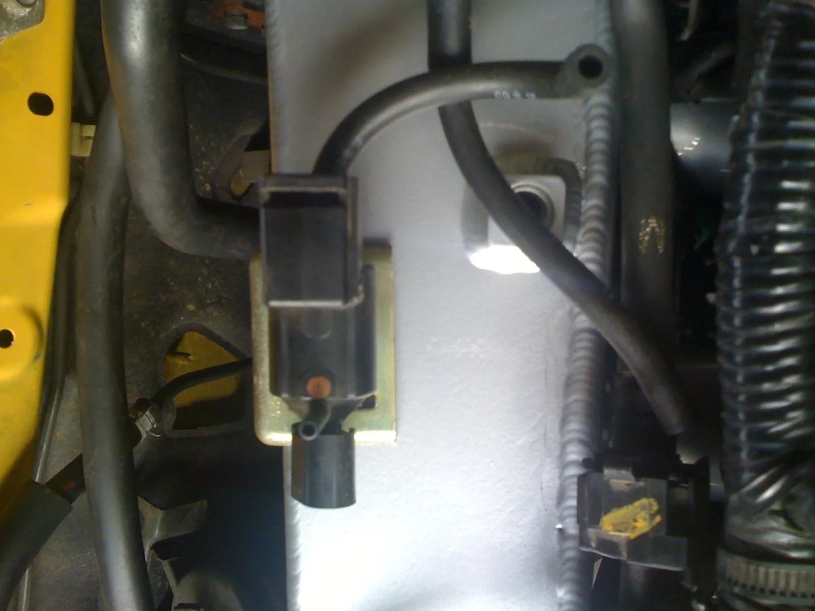

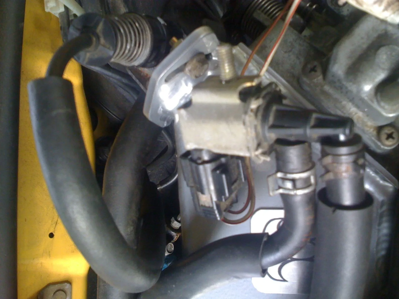

Solenoid Pics
Here's my FPR and Purge solenoid pics. They're not hooked up yet, so it's probably not what you're looking for. I can take a pic of my turbo'd P5 if you're looking for reference photos.

Got mike 2225's up and running the other day. We had to use a 626 fuel rail and then weld on different brackets. Fun.
For all you guys struggling ewith the FPR solenoid, it's not required. Leave it pulgged in so you don't get a CEL, and run the vacuum line right from the manifold to the FPR itself. It's for emissions purposes, and won't harm anything being out of the loop. Brian MP5T and I ran like that for years on the stock ECU, no problems.
