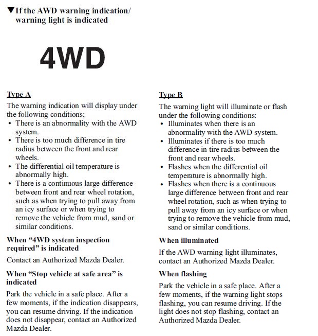

I have a 2014 AWD Touring model and I've noticed that when I start the car all the dash lights, light up and I wondered when would the 4WD light come on? You cant switch the car into 4WD so what's its use?
Section 7-26 in the manual has a bit of info about this.

My 4WD light has come on- but I haven’t been driving recently. (Literally not driven in 12 days). Thoughts on what’s going on?
@Lorac what year model? mileage on vehicle?
do you have a picture of the 4WD light and does it flash or stay on?
did you read this post?
a few things that come to mind
very low tire pressure (maybe even faulty TPMS)
wheel speed sensor
ABS sensor
failing battery
