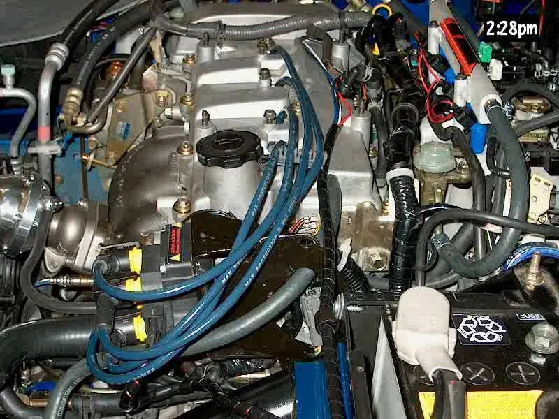

Yes the beast lives. Here are some photos of the new MPI ignition system.
whats a greddt fatt?
Glad to hear its running!! Now we all can't wait for some dynos. I mean, come on really, who ever thought a protege would have 400whp?
Thats an intresting looking ignition box or amplifier....
Again glad to hear its running.
LOL... lethal voltage.... I've always had to smile at signs like that.... everyone should know that voltage wont hurt you, its Amperage that kills
