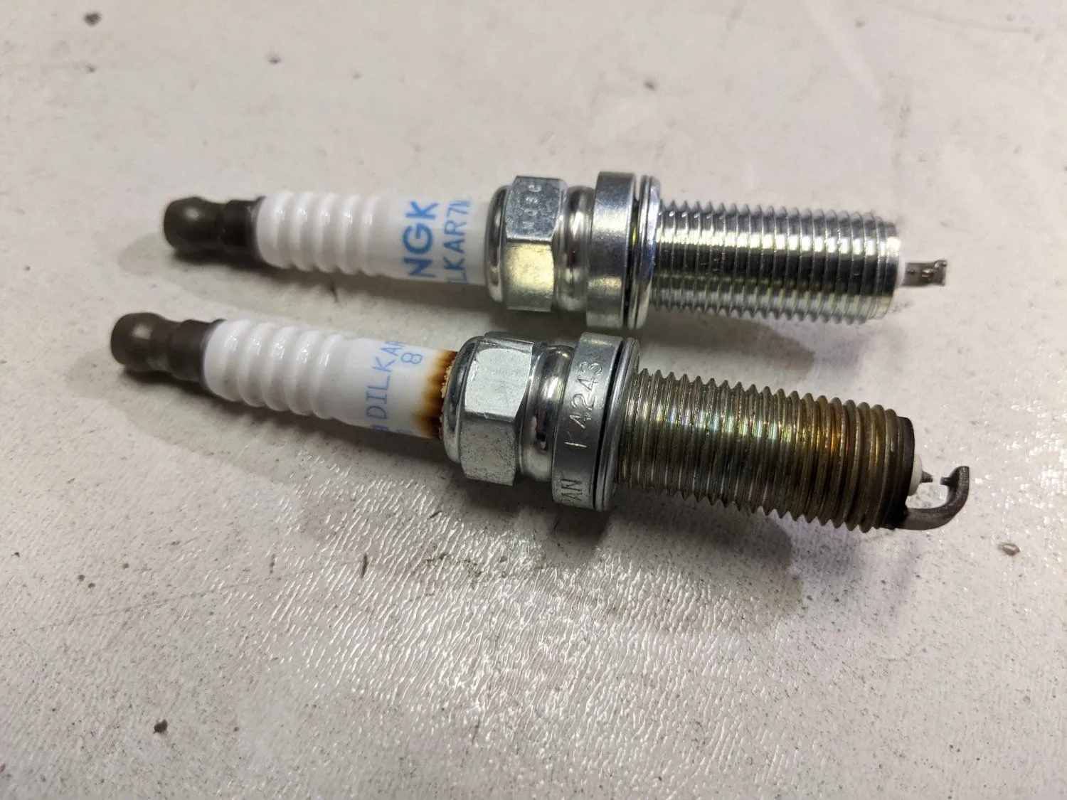

So I finally got around to changing the spark plugs. Since I bought the car back in January with around 99,000km, I wasn't sure if the previous owner changed them out at the 80,000km mark as they're supposed to. It turns out they didn't. So good thing I changed them now. Here's what a plug with 101,000km looks like. Not too bad but some very distinct singe marks on the base of the boot. The electrodes seem good, even checked the gap and they're still in spec. 👍🏼
Nice, how was the job? Fairly easy/straightforward? My CX-9 just hit 53k so I've got little more time before I change mine out.
