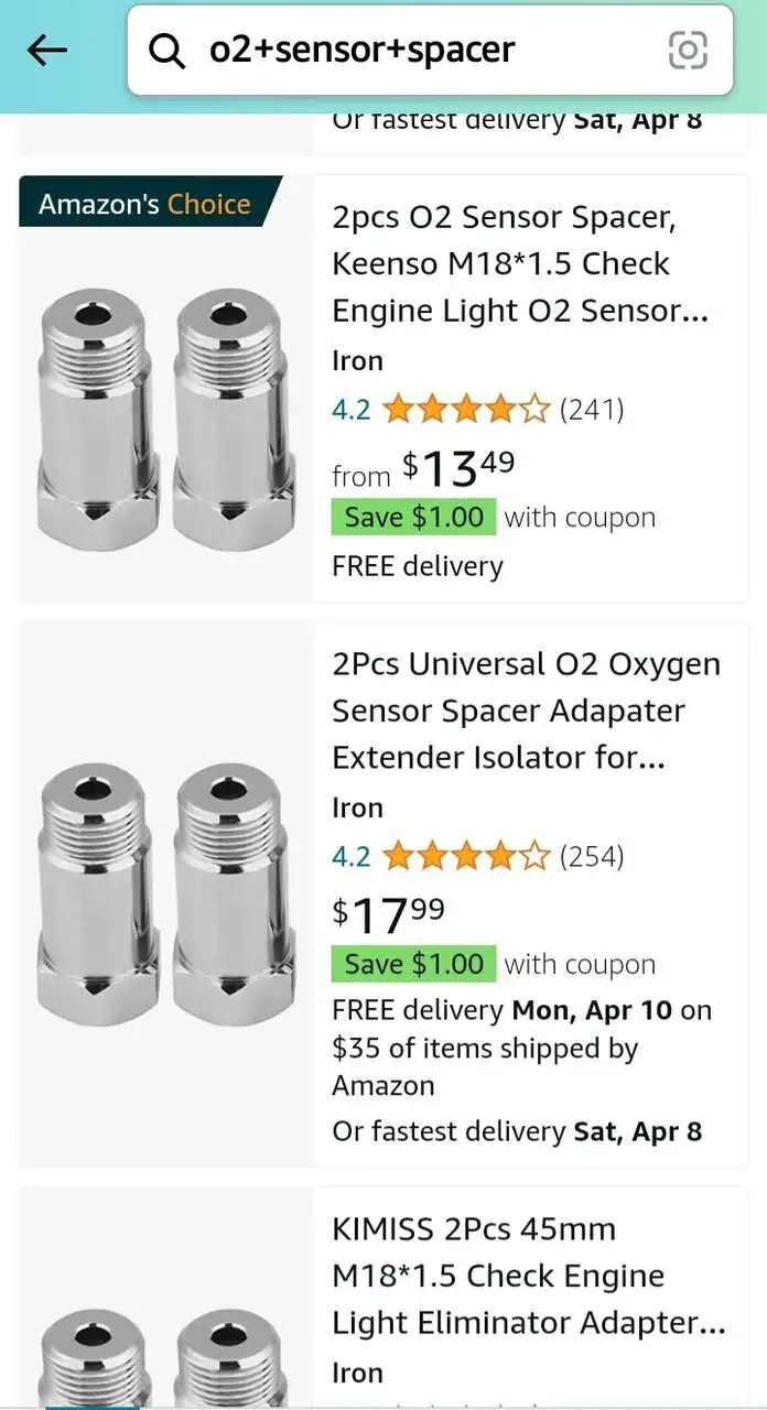

That is usually eliminated with the non-fouler trick.
Make sure it's got M18 metric threads as well as your O2 sensor bung on your header. (I kinda think that is the standard O2 sensor size?, but not everything is metric)
I know that you can use a non-fouler to eliminate the P0421 code when pre-cat if fried, and you install it on the upstream O2 sensor.
Your header may have an O2 sensor bung and you can install the non fouler and O2 sensor there.
njaremka's method of relocating the upstream O2 sensor behind the second cat makes sense to me too.
It will be monitoring the condition of the main cat instead of the pre-cat.
You probably wouldn't need the non-fouler then?
