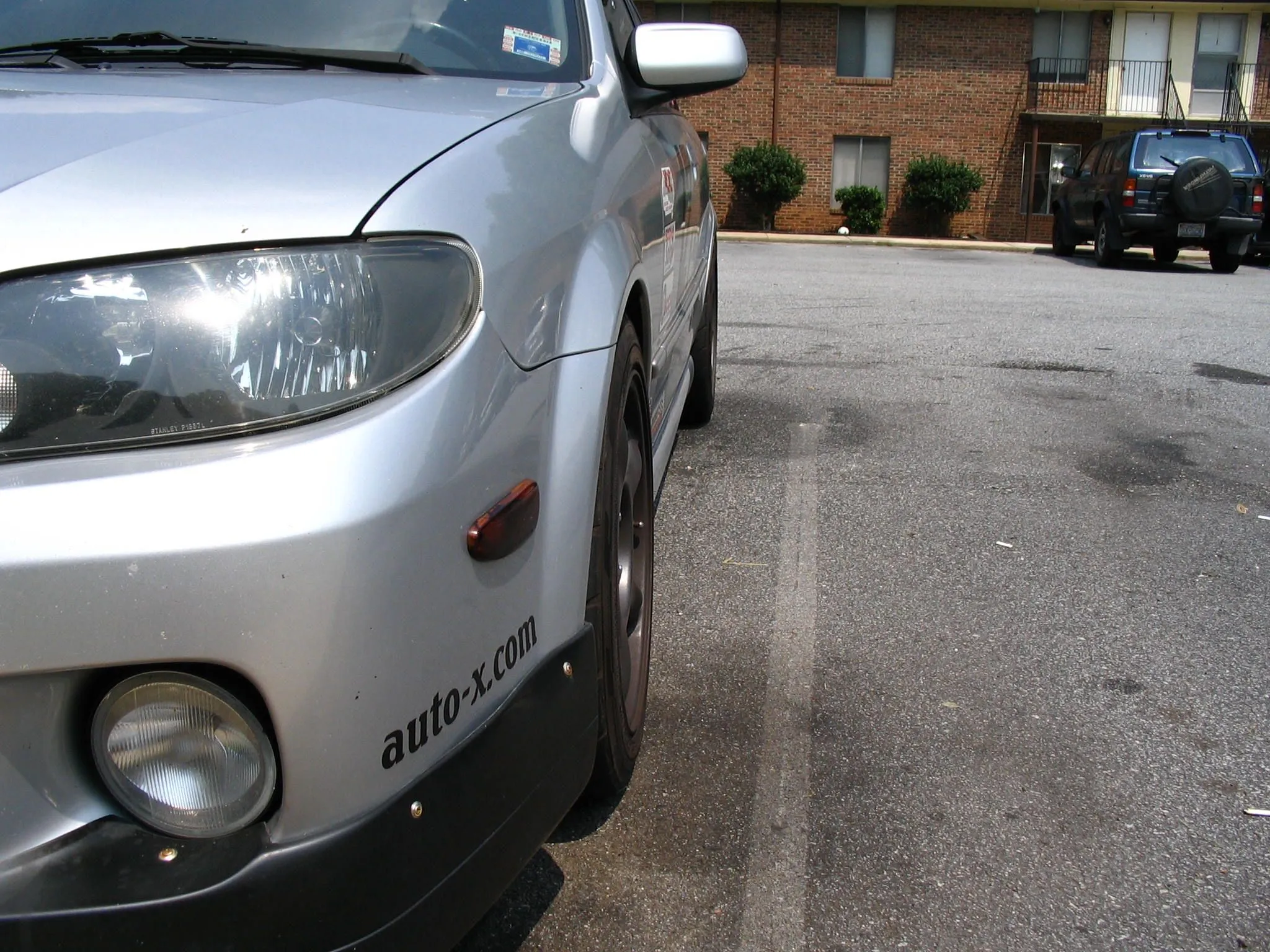

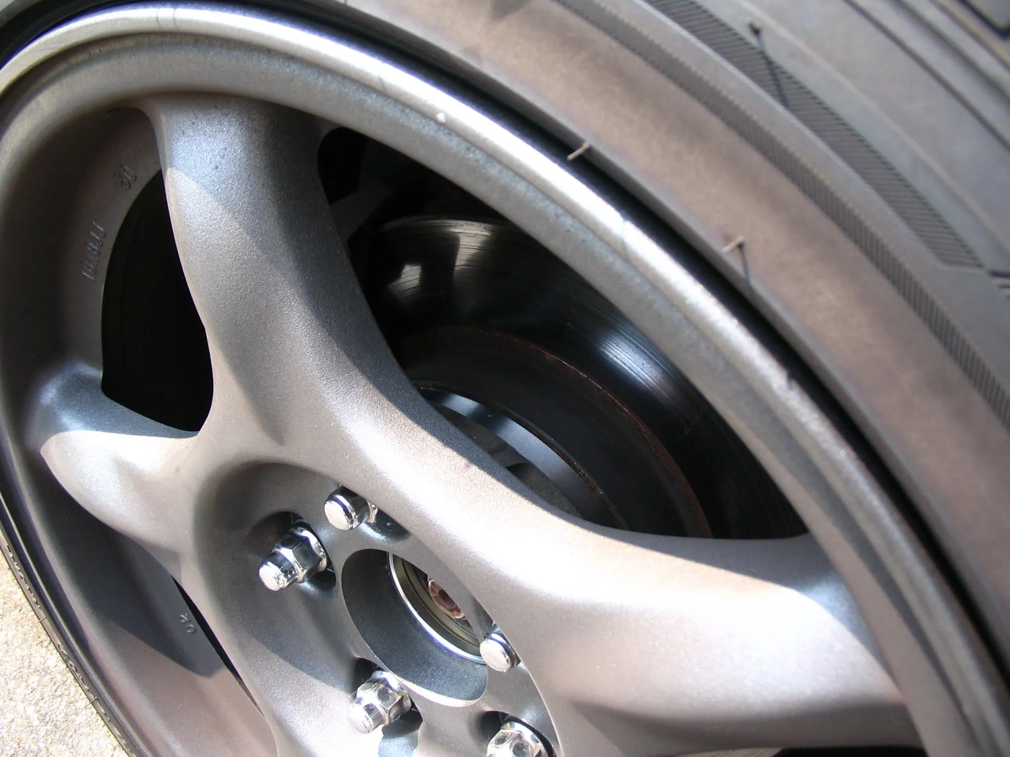

Finally got the hubcentric spacers for the front. These are 15mm...about 1/2 inch. Makes the front look more even with the back.
Looks great buddy. Question, where'd you get the hubcentric spacers? I want to get some 3-6mm ones. Hopefully that will fix my wobble too.
most tire shops can get them. IE firestone good year. they will most likely go thru their speciality tire ppl but its possible. if you know the size and everything, that will speed up the process

You should be able to source HR hubcentric spacers in the 67.1 centerbore. They will also come with longer studs. I have done this in the past. We actually did the FD setup on the Protege5 a few years back but because of needing to purchase spacers we opted to not go with the setup. I didn't want to press in new studs.
The HR comes in a 5mm and 15mm i believe. You can do both from there.
The FD and P5 have the same centerbore so that's a good thing.
Typically most wheels can be machined down another 3mm on the mating pad, for racing purposes. Any more than that i wouldn't recommend it. What happens is you make the seat of the lugnut even thinner and can fracture. Nobody wants a wheel flying off a car mid turn.
This is an incredible setup for the guys who find the wheels. I opted to use the wheels on my FC instead, but they aren't hubcentric. THe P5 is a great candidate. MZ3 and MZ6's are even better. Won't need any spacers.
Oh and there's two types of FD wheels, "Cast Brittle" i don't know but sounds scary, and one other one. Range anywhere from 14lbs to 16lbs I believe. Incredibly light for a OEM 8" wide wheel.
Peace, Rishie
I'm not so sure the FD and P5 have the same centerbore. The wheels did not press completely onto the hub when I first test fit them. I had the FD wheels machined out to fit the Pro5 centerbore and now the FD centercaps don't fit. There has to be some difference in there. I went with the Ebay spacer even though the centerbores were a little off since it was crazy cheap and I could easily modify them with my lathe.
The centerbore is the same. It could be because of the thickness of the dust cap or that part of the hub area. We had the same issues with our Rota Subzero run the first time. All books will show them as the same.
Either way, your point is a good one. These wheels are an amazing value if you can source these spacers. I'll see if I can find out for sure.

Hmm...interesting. I'm thinking that the centerbore on the FD rim is just not machined deep enough. I remember when I was checking the depth we were going to have machine the FD wheels to it was almost all the way through.
Hmm... I'll have to keep an eye out for those. What is an Integra Type-R centerbore? I know it'd be easy as pie to find hubcentric spacers for those. Edit: Crap, 64.1mm, should have guessed.
Although these ones for an Eclipse look like they should work: http://www.optionimports.com/10656715.html
Yes the Eclipse and EVO are also the same centerbore but the Studs have a different "nural" sp? spacing or something. You know the spline part of the stud that would press into your hub.
The Type R centerbore is actually smaller than the P5 and FD so that would require opening up of the centerbore.
I do believe that is the issue with the FD wheel, the bore needs to be deeper and this should only be an issue in the rear of the P5.
Rishie

Yep...when I test fit them the fronts hit the strut before they were fully seated so I couldn't test for depth there.
