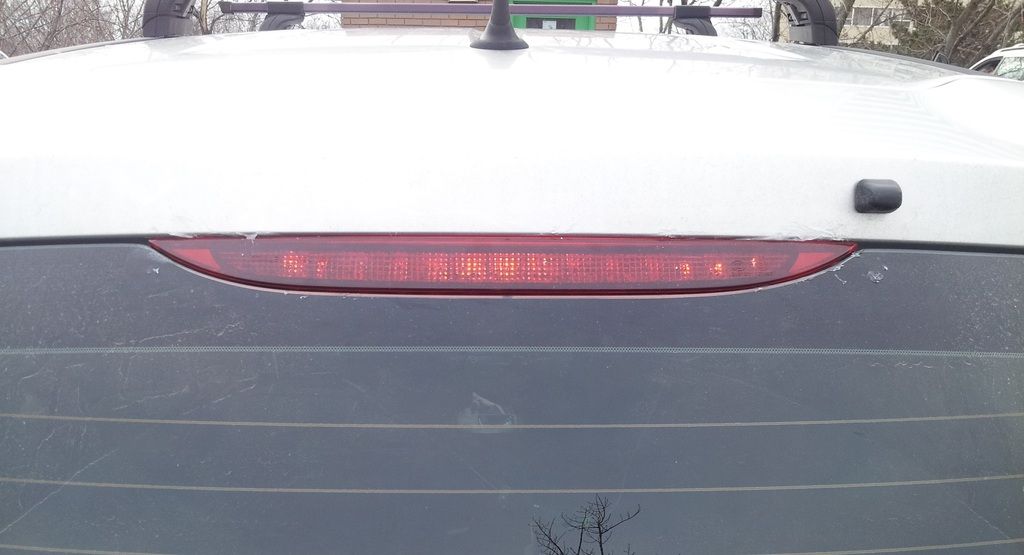

My mazda 5 tail light failed as well. Connector is all corroded. Something is rattling inside the LED third light too... commencing search of online junk yards. thanks for the link.

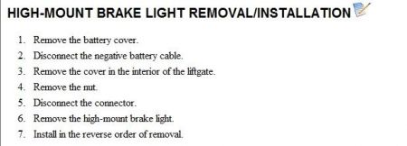

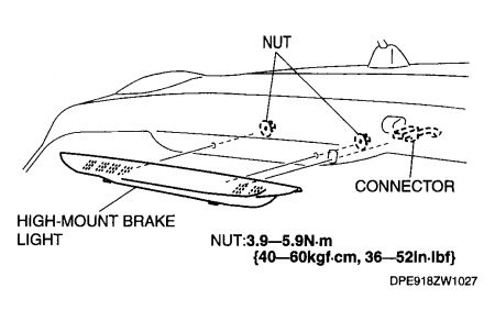

Posting diagram and part number (C235-51-580D) for MY '06-'10 as reference:

Removal is easy on 2nd gen, not sure about others. Open the hatch. I used a screwdriver to pry off the panel, remove the connector, removed the nuts, and pulled it off. Like someone else mentioned, mine also has something rattling around. Took some pics of my work

Hi, I have same issue with my 2008 mazda 5 3rd brake light.

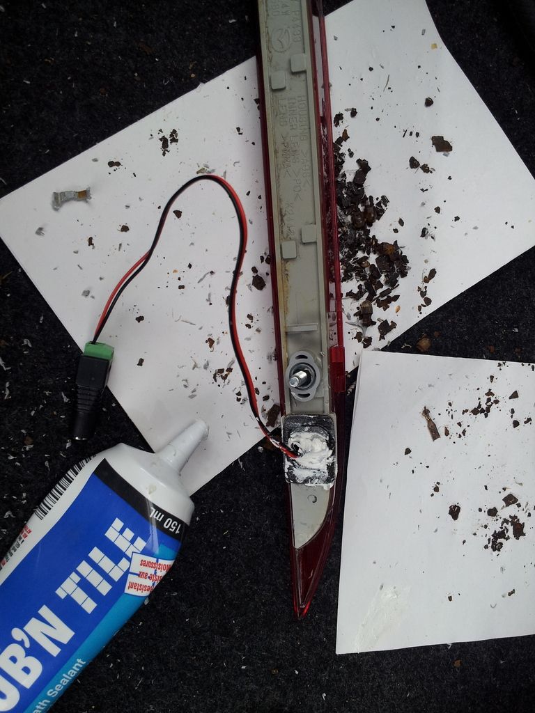

For mine, like the others on this thread, the connector on the light assembly itself was rusted through and no more electrical contact.
Also the connector on the wire connecting the light assembly to the car electrical system was also badly corroded.

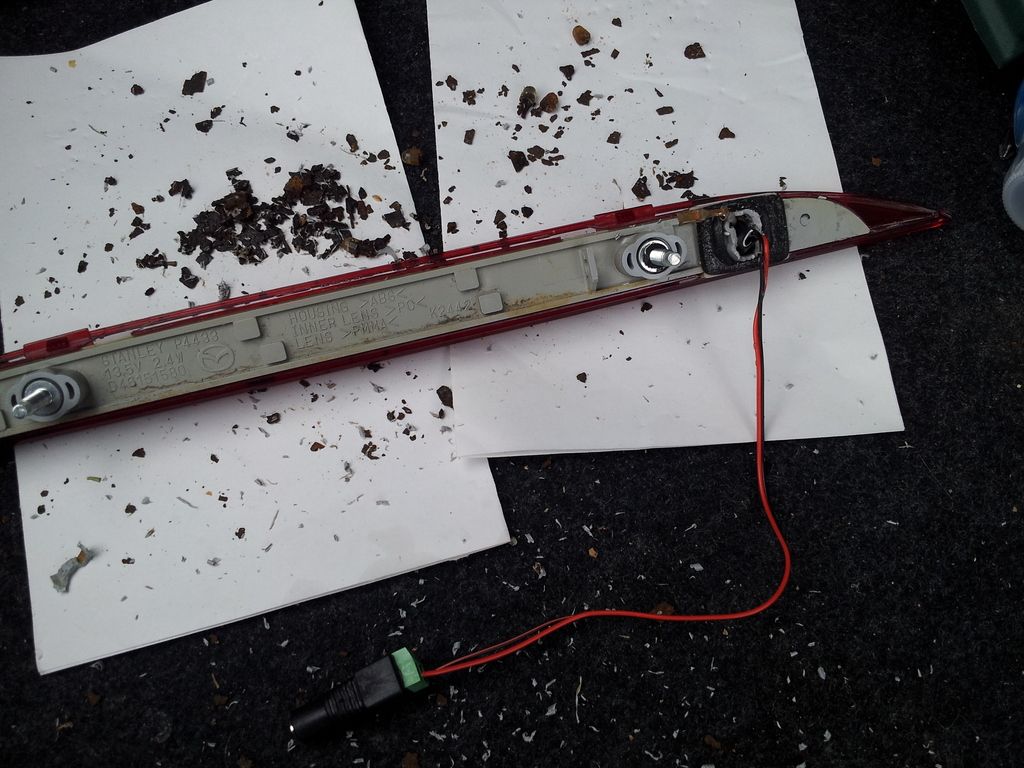

So a friend got the idea to try to directly connect the wire to the LED strip inside to bypass all these corroded connectors.
Strange that inside the sealed assembly it looks like lots of pieces of dirt or small rocks when shaking it...

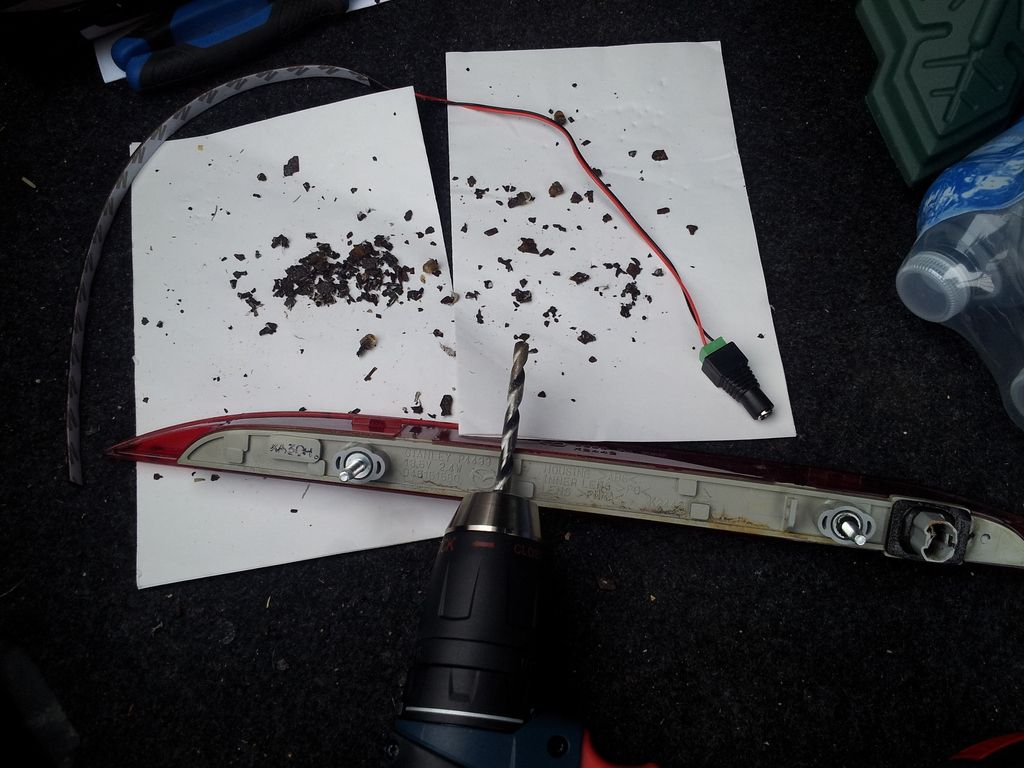

Spent over 1 hour with friend dremelling out the connector on the assembly and shook all the "rocks and dirt" out...the rocks and dirt turned out to be entire LED strip itself -- DISINTERGRATED --it seems to be a ceraminc strip with 8 LED lights - all 8 lights and what looks like a transistor shook out with the broken up ceramic they were attached to....brutal, I have a picture but can't attach here. Will be out another $200-300 bucks for another part only from mazda. Junk yard one would not last like someone here found out since junkyard ones are probably well on their way to disintegration already.
I hate mazda...
ps - project when have time is to insert my own led strip into my now empty 3rd brake light assembly, don't want to give mazda another cent for this...

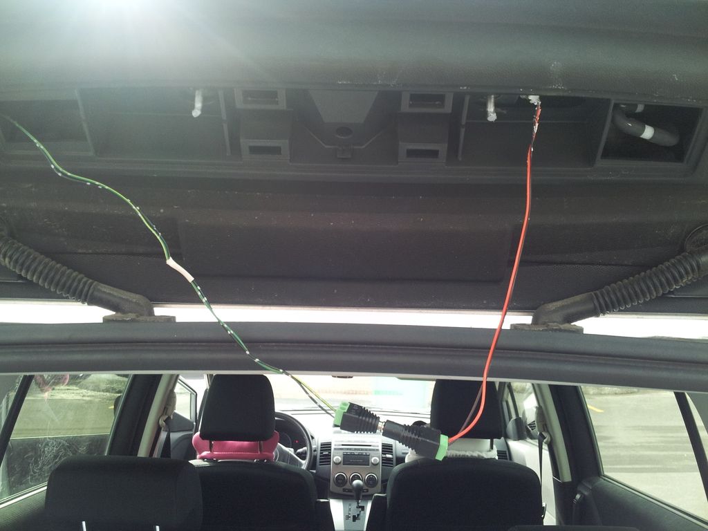

Here are pics of my $3 fix:
(pack of 8 LED strip lights for $11 on amazon, some solder, crimp connectors, silicone):

Looks good Chessman. Can you post the link to the strip LED you used? Also, it looks like more than 8 lights?
I hope I'm allowed to post links, here it is:
https://www.amazon.ca/gp/product/B01KRL88LO/ref=oh_aui_detailpage_o08_s00?ie=UTF8&psc=1
What I like is these were already the *perfect* length with connected bare wire ends; exactly long enough and not too long to fit inside the assembly. I didn't feel like cutting and soldering a 5 meter strip. Has 15 LED lights on the strip giving good brightness.
Inserted and fit into my dremelled out connector hole perfectly, and the strip itself is waterproof to boot.
My coworker also has a mazda5 and never realized they were driving with 3rd brake light out for probably a very long time. Gave them a strip and this forum thread to fix it :)
One more thing. I see where you drilled out the connector. Where did you crack it open to remove all the stuff in the first picture?
So before I order, I need to ask how you got the strip to sit in there without falling off? Is there just a small area for the light to go into instead of the whole bulb housing?
The strip is flexible with nice thick waterproofing, so I just inserted it in with the lights facing out and chaulked the soldered end in place at same time plugging up the hole. It snaked in there surprising well, I was also thinking how to keep it in place but it just snaked in there and stayed in place.
Note I didn't remove the 2-sided tape backing, just left it as is so it slid in nice and smooth.

Did a quick and dirty fix for friend's 2008 mazda5, exact same thing. Didn't feel like crimping/soldering the leads so waited for 12v screw on connectors to come in from china :)
