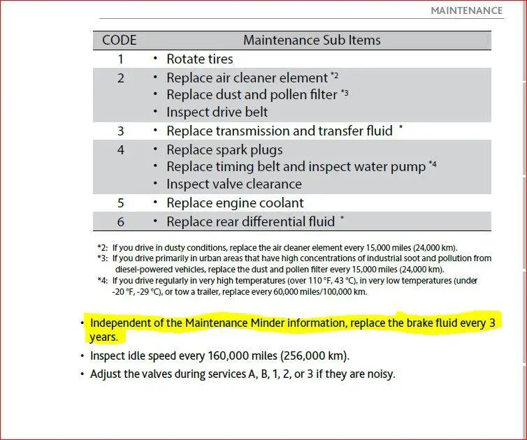

Owner's Manual from 2015 MDX shows to replace brake fluid every 3 years, regardless of mileage driven. I heard some vehicles recommend 2 years interval?
The weather here in PNW is very humid and the BF is hygroscopic, I'm inclined to do more often.

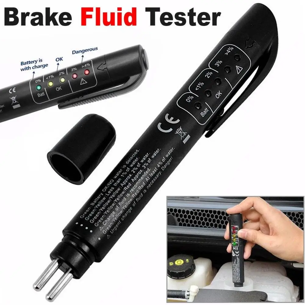

Really, we can just use a brake fluid tester to test moisture content. If it exceeds 2%, replace the brake fluid.
