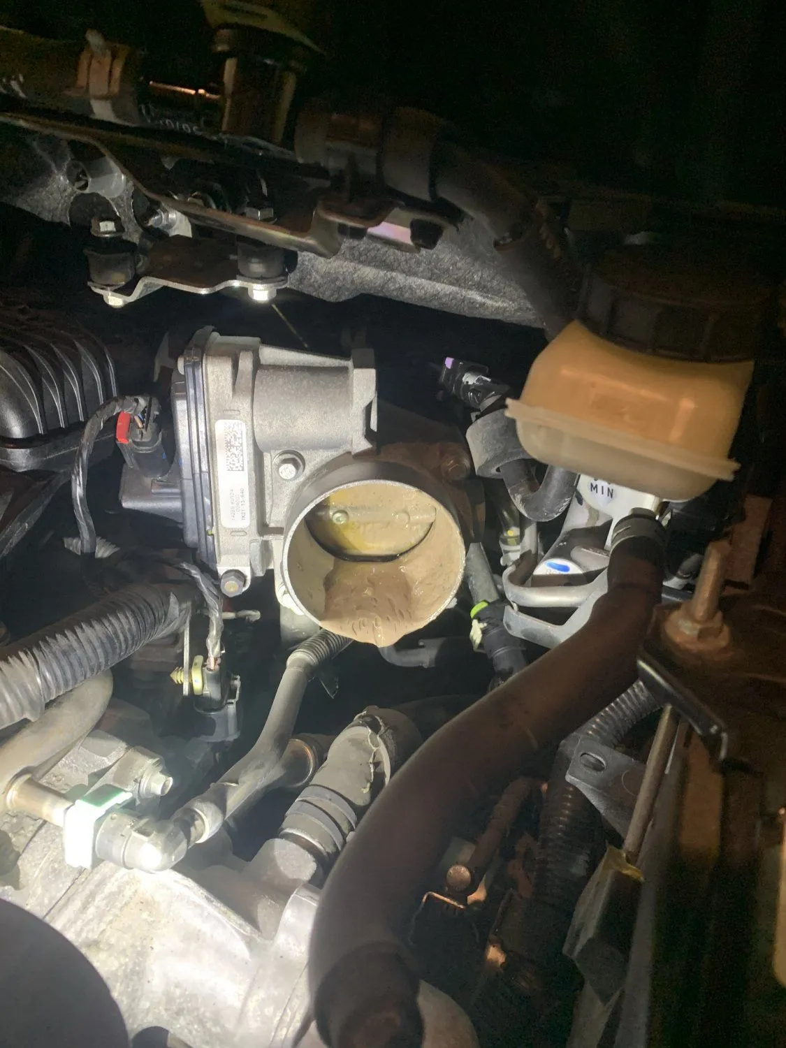

So Ford engines won’t work in a cx9 I have a 2015 and I have coolant in my oil I figured it was a water pump that went out. I filled the coolant tank with water since it was empty and checked the oil and the dipstick was half full. So I dunno what’s going on with it. Was gonna try to get a Ford engine and put it in instead of the Mazda. Would anybody know if I could use a Ford one? This is my throttle body. Could use any help please!
