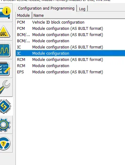

I have attached my AsBuilt. I have European -11 model, with xenons, rain-/light sensor, automatic headlight leveling, front- and rear foglights.
My model doesn't have any DRL's, but all the lights are on, when driving.

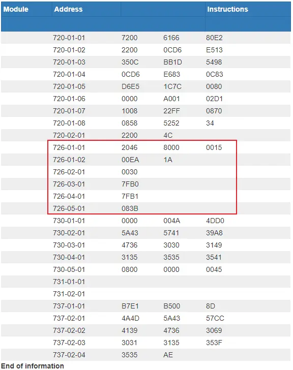

I had nice freetime on weekend, so I played a little with Forscan and different VIN-infos, what I managed to find..
What I think, is BCM's first row (726-01-01) is attached to lights.
I have 2046 8000 0011, and trying to find different VIN's, my guess is that first two digits are everytime same 20, third digit might be market area, beacuse every US cars had 2, Europe cars had 4 and couple British had 1.
But changing that didn't make any difference, lights worked same, front fogs worked as before, come on when parking lights are on, doesn't shut when high beams are on.
Rear fog worked as before.
Fourth digit makes a difference, but I could notice only two different modes:
1. All the lights light up when switch is OFF or AUTO
2. Lights are off, when light switch is OFF. When switch is AUTO, the lights light up when dark.

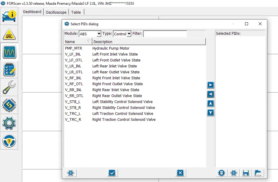

I had the time to check! :D
In Service functions, there isn't sevicemode for ABS-pump, only different ABS calibrations and module reset -functions.
But, in PID's functions you can control ABS-pump ja valves, so I guess you could bleed the system with this.
But I have 2gen and don't you have 1st gen? I'm pretty sure they are way different.

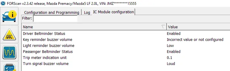

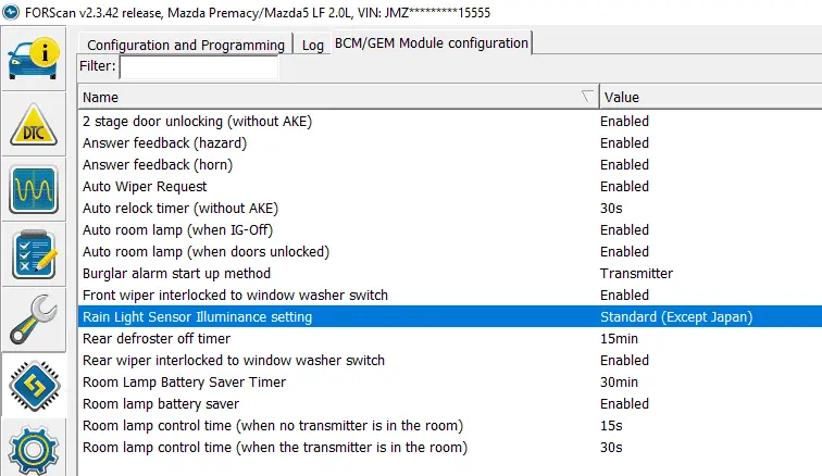

Thanks, this is great! This post will be immensely helpful to those with ABS issues (soft/spongey initial pedal feel), and I put refence back to this post. I suspect the menu option should be the same for both gens but someone else will have to confirm.
A few more fun things to change default:
-Can you find the setting to turn OFF the seatbelt reminder ding? I know the dealer can do it so I'm pretty sure there's an option somewhere. A screen shot of the setting for future reference would be great.
-Does it have option to turn on intelligent 3 blink turn signal (one soft tap = 3 blinks for lane passing)?
Yes, for seatbelt reminder, passenger and driver.
I've attached pics of IC and BCM options what I have available.
And no for the 3 blink turn signal. It can be done mechanically, not by changing codes..
Mazda has it's own original retrofit kit for it: C830-V7-160B

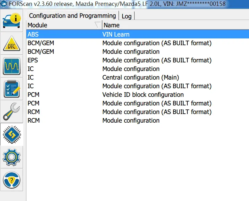

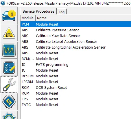

Hi @Maikel. I hope you still have access to for scan on your mazda5 2gen. I just wonder if you could help me out by checking in the "program" menu of forscan while connecting to your 5.
I too have a mazda5 (CW), and is working on replacing the ABS module. I bought forscan too.
however, unlike some online tutorial shows, there isn't a 'as-built' item for the ABS module. (i'll update a screen shot later) so if you can check yours to see if it's identical that's great.
thank you for your help.
Hi yiqi!
Yes, I can still use forscan. But I'm not 100% certain what did you mean by program menu?
Mazdas are much more simpler than Fords, so we don't have nearly that much stuff than Ford people have in there.
There's printscreen of what I can see from my CW.
Hi yiqi!
Hi Maikel,
Thank you for your response! Yes this is the menu I mentioned.
What's a bit strange is there isn't a ABS in your screen shot (9 items); From what I get it's like:
I'm going to replace my ABS module (C513-437AZ-A) which has a known issue (C0020:1B error code, that the module can be seen as faulty in its electric part - while it actually works well)
And what I plan to do is to get a used part from a Mazda 3 (the part number as BFD4-437AZ-B.
It seems the "VIN Learn" is the only thing I need to do and hopefully it'll work...
BTW i'm in the UK and my Mazda5 CW is UK model. Maybe that's the difference (between our screenshots)
Hi Maikel,
Hi yiqi!
Okay I can now confirm a few things:
1. swapping the (C513-437AZ-A) ABS Module on the Mazda5 CW 2010 UK model does work with a BFD4-437AZ-B (from a 2012 mazda3). It works immediately when it connects, the cable, no warning light and reads no error code.
2. it turns out I don't actually need to do even the "VIN learn" on the replaced ABS module. (Although I did do some sensor calibration options from Forscan). Anyway Forscan is a great software and ⭐⭐⭐⭐⭐ recommend it!
