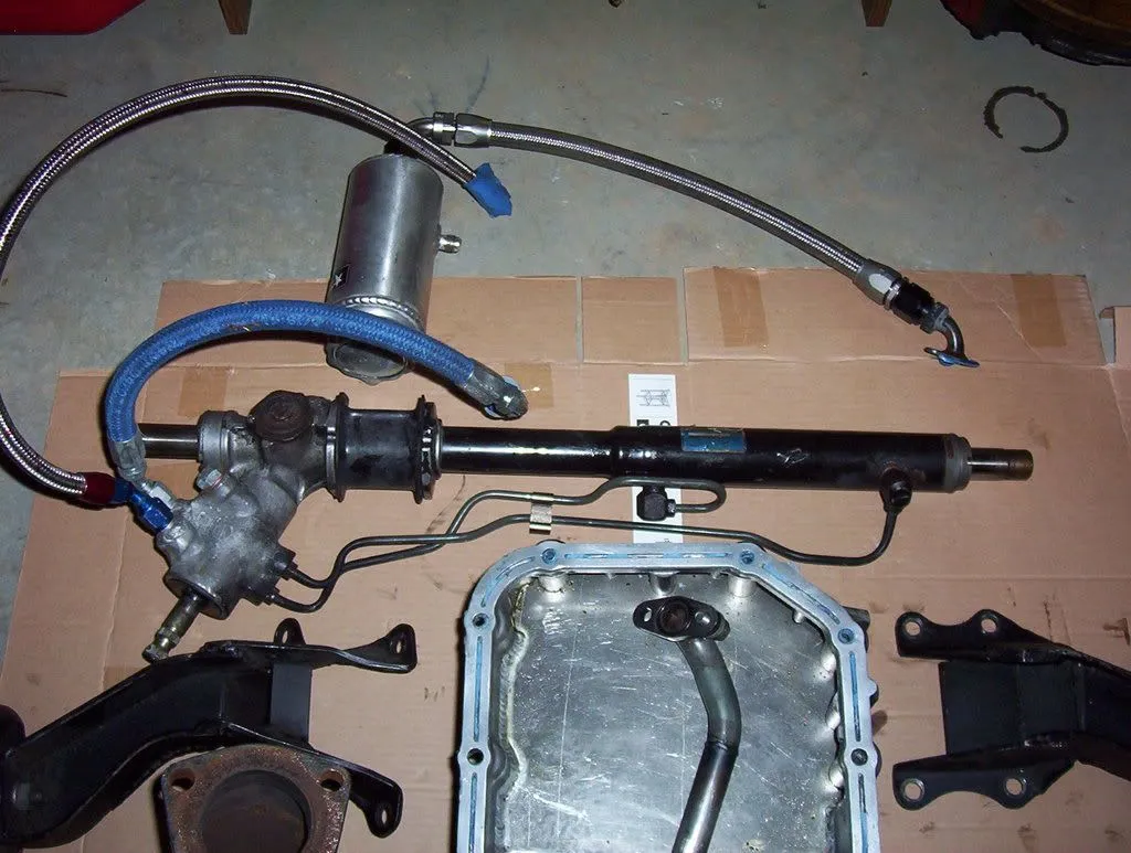

sorry to bring this up but i was wondering if you got any pics on how your powersteering hooked up i have the same motor in my fc but im not sure how to hook up the p/s
I had the same problem, no one would answer me on the forums, lol.
I think what I did was block the small pressure line down at the rack, the large pressure line threaded right into the jz power steering pump, I ran the return line up to a small custom mounted reservoir and from the res back to the return side of the pump.
the res I used was off a 1g dsm, it was perfect, small enough to fit nicely with out taking up to much room.
I read that you can plum the small pressure line to the return line and this will give you slightly stiffer steering for better feed back when driving.
the way I have my power steering hooked up, the steering feels like an old oldsmobiles power steering, it requires no effort at all to turn it, which kinda sux for cornering, but I am a straight line guy any ways so it dosnt bother me that much.
i have the pump and res in but people on the forums kept telling me diffrent things like plug the small hole and use the rack that way and other people say put a odd (T) in and run it like that i just can never get a real answer i plan on useing the car for drifting so i would like to be able to handle the counter steer and im not that big of a guy thanks for giving me a real answer because i keep being spun in circles
this is how my p/s is hooked up top line is return middle line is high pressure 3rd is pluged is that right only reason i ask is because it seems like its not doing anything but im not sue if maybe the pump is shot does that look kinda like how yours is plumbed
