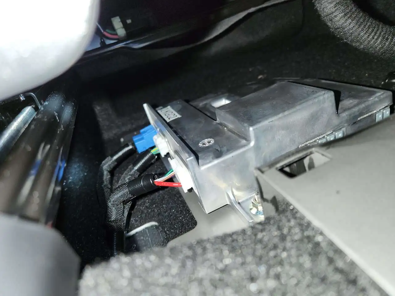

Hey. You are right. The amp is under the passenger seat with a black cover over it. Thank you! There are 3 harnesses attached to the amp. A blue one and 2 white ones. The white one in the middle looks to be from amp to speakers. The white one on the end has power and ground wires and a set of other wires (about4). Are these the signal in cables? There doesn't seem to be enough wiring. If that is the case, how would I connect a 4 channel amp without still using the existing amp to provide the signal? Normally I would connect the signal wires to the new amp or an LOC and connect the speaker cable that was connected to the old amp to the new one.

Many new cars have digital inputs from the head unit to the amplifier, because the music, door chimes, and other sounds are carried by the CANBUS to be played through the speakers.
Again, no idea if Mazda has started doing this yet, but it is very common. You really need to measure the signals both into and out of the amp.

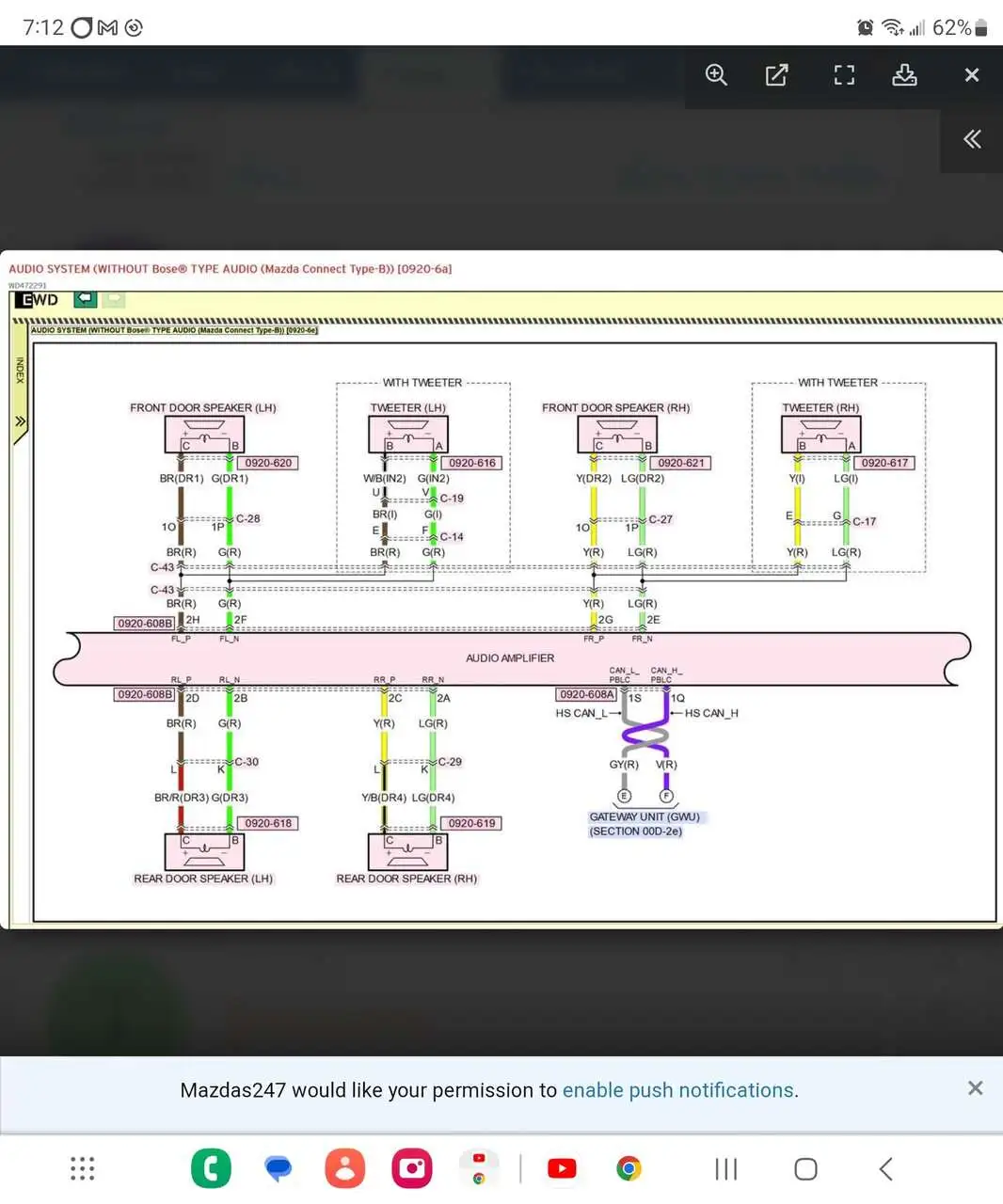

What color wires did you tap into? I'm trying to install a sub as well. I had bought the PAC but it didn't fit.

Here is a diagram for the cx5. There are 3 harness connected to the amp. The white one in the middle is for the speakers. On that harness, the top and bottom inner wires are the front. The top and bottom most outer wires are the rear. I tapped into the inner which wasn't my intention but it worked out. I was going for the rear but tapped the front. Didn't feel like changing it. The diagram for pos&neg are correct but the location of where they run to could be different so test if you can.
