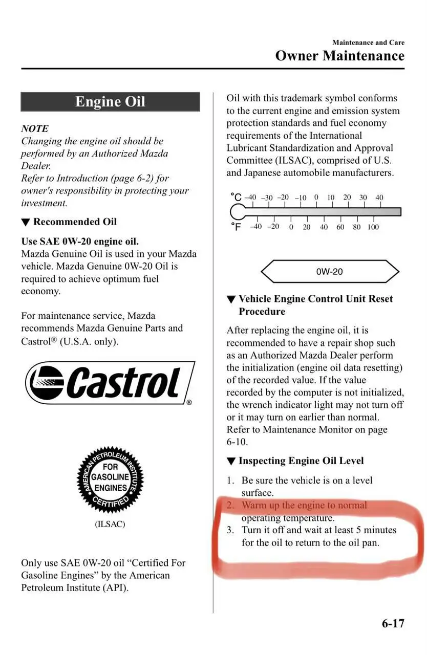

We do not know that. For my 2018 the manual says, and I paraphrase from memory, 5 minutes - (or any amount of time more than that) - after warming up the engine then turning the car off.
That could be 5 minutes, or 2 days, after turning the car off.
I never check when hot, usually wait couple hours or next day. I'm pretty sure Mazda recommends the 5+ minutes. I'm sure that's so you don't check the oil right after turning it off before the oil has flowed back in the pan giving you a low reading.
FWIW, I checked the difference in dipstick oil levels between dead cold (50*F) and following Mazda’s recommended technique (run 30 minutes then check 5 minutes after turning off). The oil level checked hot was about 1-2 mm higher on the dipstick.

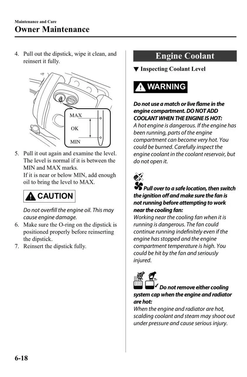

You’re absolutely correct and I agree with you totally. Here are the wordings from the 2018 CX-5 owner’s manual on how to check the oil level:
It says “wait at least 5 minutes for the oil to return to the oil pan”. Yes that could be 5 minutes, or 2 days, after turning the engine off. The manual emphasizes “for the oil to return to the oil pan”, that’s the reason for waiting, nothing about hot oil temperature.

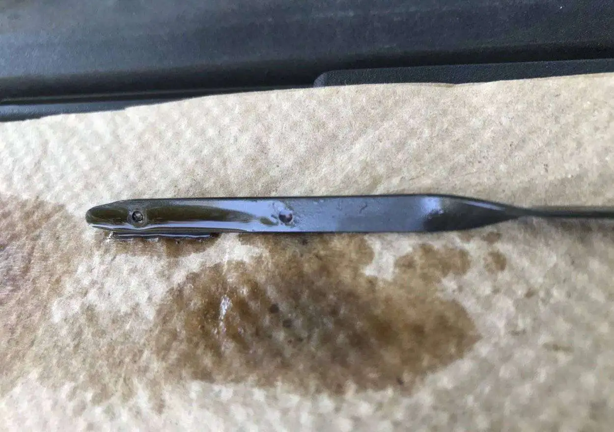

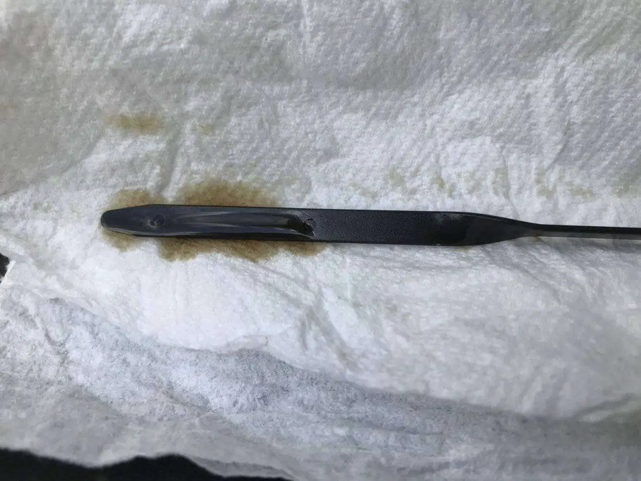

In addition, I’ve also compared the oil level measured hot and cold on my 2016 CX-5, there’s almost no difference between the two:
Hot (5 minutes after the engine turned off):
Cold (next day in the morning before the engine start):
That’s why I always check the oil level the first thing in the morning before the engine start. It only needs one pull on dipstick, no wipes, and the oil level is much easier to see.
