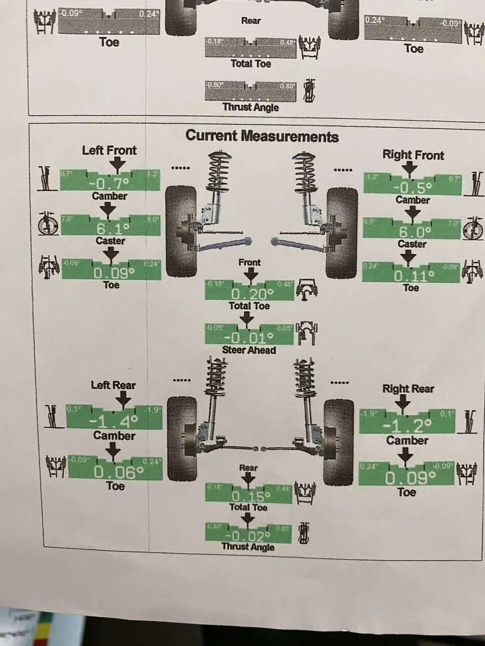

My 2021 CX-9 AWD Signature with 8000 miles wanders at highway speeds. Not a lot, but just enough to make driving long distances tiring.
I have found that almost all new and used cars that are sold are out of alignment!. My sons and I tend to buy a lot of cars (and we love Mazdas), and we counted 6 cars in a row that we bought (mostly new ones) that came from the factory out of alignment. My first one was a new 2012 Mazda 3i that I thought was just designed badly, until 1 1/2 years it was just out of alignment. After the alignment, it was awesome!
Back to the story... I had Mazda check this one twice, and both times they said it was in specs. I had them give me the specs the last time, and it looks like it has a bit of toe out (which I understand can cause instability). Does anyone have recommendations on what settings to set it to?
Here is what I have:
The first setting doesnt say what it is, but I think it is Toe.
(Left/Right)
Front -> -0.7/-0.5 Camber -> 6.1/6.0 Caster -> 0.9/0.11
Front -> 0.2 Total Toe -> -0.01 Steer Ahead
Rear -> -1.4/-1.2 Camber -> 0.6/0.9
Rear 0.15 -> -0.02

Alignement can make a car less stable and more prone to follow road variations. Not really a wobble, but still requiring constant corrections. Your left rear camber is pretty far to the right. It is barely within spec. You could see if you could get that one closer to spec, maybe that would help. Same thing for your left front camber.

My car with the Falkens drives straight & steady. For alignment, especially if you're paying, not a warranty job, tell them that you want the setting in the center, not just "in spec."
(Left/Right)
Rear 0.15 -> -0.02

Thank you everyone for your advice. My wife has the car out of town right now, so I'm not 100% sure what tires they are. They don't pull to the left or right and are really smooth, but just are overly sensitive. I will take it in for an alignment again (the 3rd time) and see what they can do.
I am very careful with tire pressure, so the pressure is correct in the tires. I also have had a Mazda 3 straight from the dealership with about 50 psi, and was not happy! That is a good note about possibly having a defective tire, and I'll try a tire rotation.

I'd ask them if they could get those values centered and have it covered under the 1 yr/12k mi adjustment warranty. That warranty will also cover balancing
