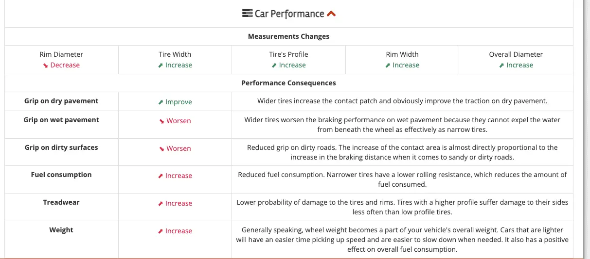

I have a 2019 CX-5 Signature with stock 225/55/r19 and 19x7 +45 offset. I'm now looking at the following combo: Enkei TM-7 (storm grey) 18x8 +45 with Nitto Nomad Grappler 235/60r18 107V XL
In the past 48 hrs I've gone down the rabbit hole and have learned a lot about tire and wheel mechanics. I like how the cx5 handles presently, so I'd rather not deviate too much from stock specs. I understand that my speedo/odo meters will be inaccurate, and I'd probably have improved handling given wider tire/contact patch and stiffer side walls (V rating), but I don't want to mess with scrub radius, offset, spacers, etc.
From wheel-size.com and attached screenshots. I gave wide safety margin for clearances:
fender 32 mm
wheel well 25 mm
suspension 25 mm
TLDR:
Anyone with 2nd gen Cx-5 (stock suspension) running 235/60/r18 on 18x8 +45 offset combo?
How much clearance do you have from fender, wheel well and suspension?
Any issues with rubbing at full lock?
Thanks again, this community is great!
