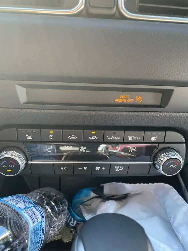

Hi. My daughter has a new 2021 CX-5 GT and called telling me her AC was not working. She is 4 hours away and has no car experience so I asked her to send me a picture of what the AC controls looked like. I attached the picture. She said she hit everything she could to try and see if she could get it come on and nothing worked. She restarted the car and said it started working again but said she had done that numerous times. Now I can't be sure what she actually tried or didn't try and all I have to go in is the picture. Do you see anything in the picture that doesn't look right that she might have hit to make it stop working or why it would not be blowing if this was how it looked at the time? She said it wasn't blowing or doing any thing as if it was off. I thought maybe she hit the fan down button but the auto light is on. Any known issues with these doing that and how to address? I'm just trying to get an idea if this is a problem she needs to have checked or an accident on her part as I'm nowhere close to help her.
Thanks for any help.

@unforgiven Idunno what the outside temperature is but the car may be @ 72 degrees inside. I would think it would still have the fan running at low speed. I assume she tried turning the desired room temperature down lower than 72? Also, (per the picture) the passenger side is operating separately from the driver side (not sync'd).
I would ....
1, push the passenger side knob to illuminate the "sync" light
2. rotate the driver side knob counter clockwise to a lower temperature or even fully low.
if that didn't work, I would push the driver side knob to turn off the "auto" light , turn the dial fully counter clockwise and increase the fan speed manually.
if that didn't work, a trip to the dealer may be in order.
Good luck!

Thank you. I will have her do this if it happens again. She is in South Florida so it was at the high at about 89F today.
I agree, turn off auto, sync both sides, twist left knob to colder temp and + fan button. Pic shows auto set at 72 and fan speed at zero which makes me think it reached that temp within the cabin and turned off the fan. I could be wrong, as I never use the auto feature. I always leave the temp on lowest setting and manually set my fan speed. When I do this, the minimum fan speed will show as one bar. I’ve never seen zero bars there. Also curious if the red showing next to the mode indicator person (knee area) icon is a reflection or actually lit up red. I don’t think I’ve seen that either.

Other users are correct that the fan is turned to its lowest setting. Press auto once to turn it off and once again to turn it back on. ( the big knob, she may not have realised the knob is also a buttong). If that doesn’t work then manually increase the fan speed by pressing the fan+ button repeatedly.

Pressing the fan button will take it out of Auto mode. If I were in FL i would keep it on manual, adjust the temp and fan speed myself.
note: When you remove it from Auto mode and then restart the car later you may have to push the A/C button again to get the system into A/C mode.

It is a solution. If she turns it off with the power button, then presses the auto switch again it will work perfectly because it is currently hung. The benefit of leaving it in auto is that it will automatically vary the temperature and the airflow to maintain the desired temperature where all the suggestions for manual will just chill the interior continuously even if it is already cold first thing in the morning for example.
