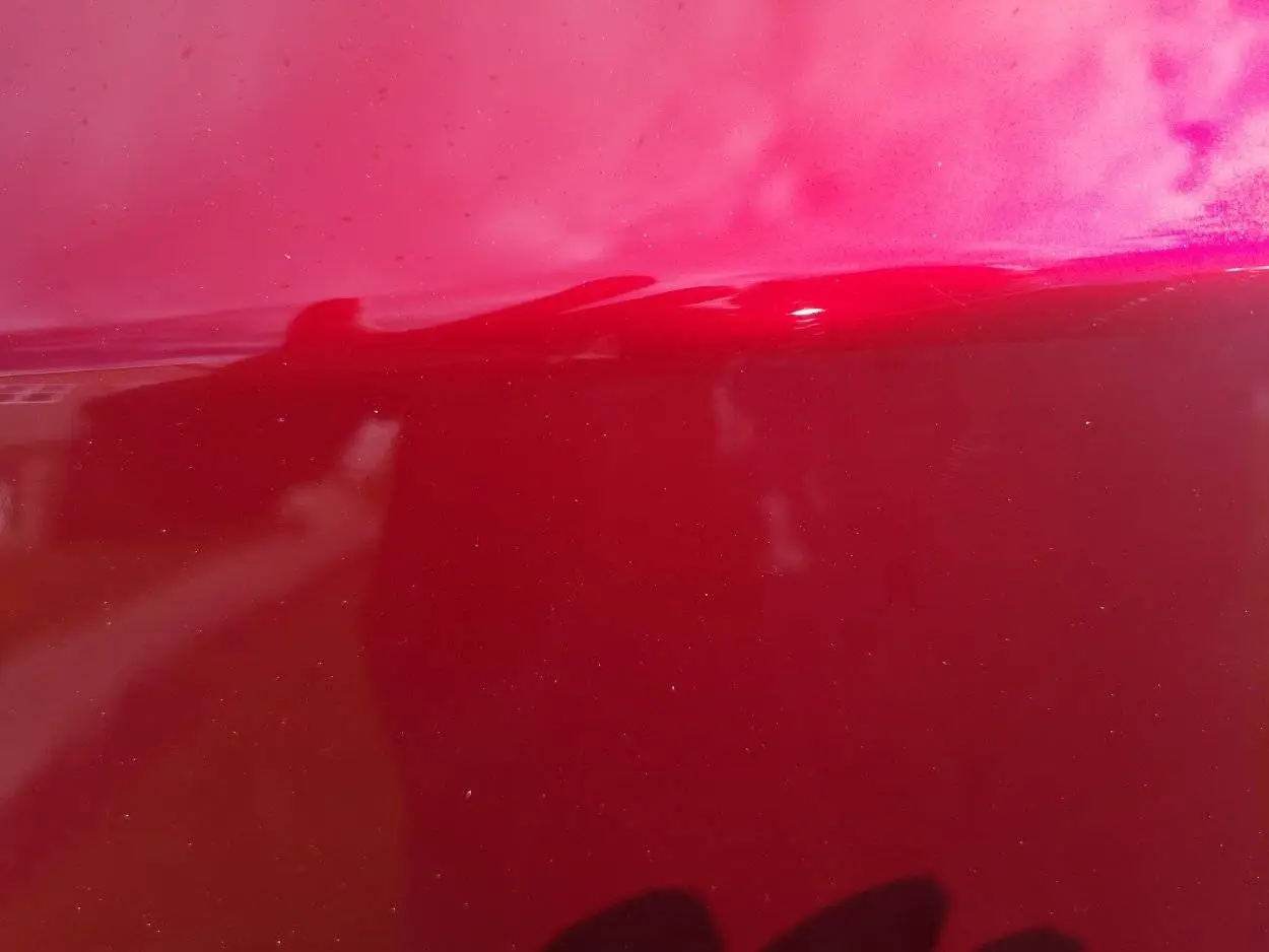

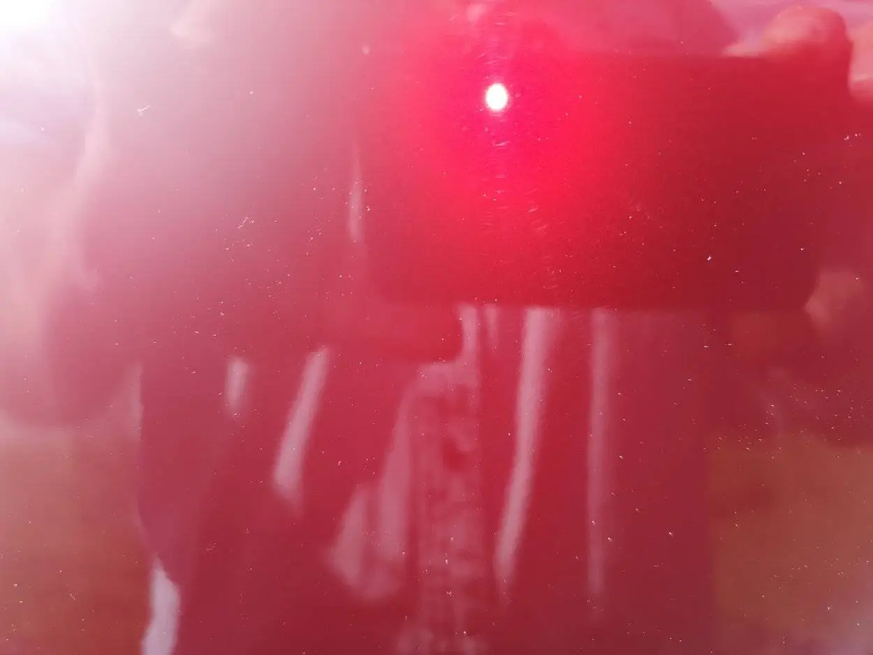

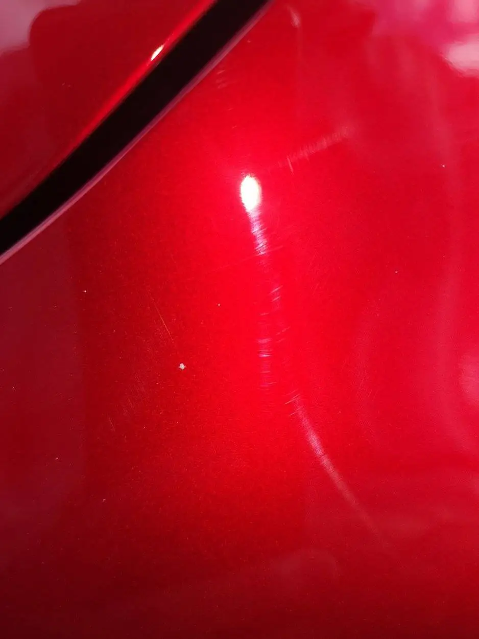

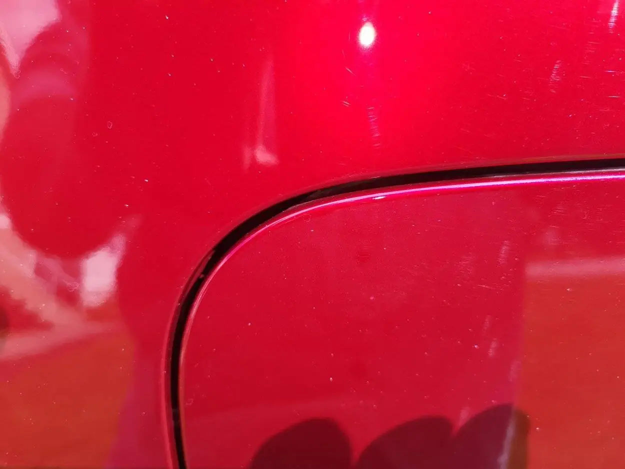

Hi I am looking for some help with my 2020 CX-5 paint and clear coat. Clear coat actually scratches if you run your finger along it and the paint on the hood is chipping prematurely but what has me puzzled the most is the specks in the paint (not embedded) but under the clear coat any help will be appreciated, thanks!

Did you buy it brand new, or used? Do you know if the car has ever been in an accident? Are the specks visible all over the car, or only on certain panels?
I haven't seen a soul red crystal metallic car up close, so I don't know if those are just paint flakes in the OEM paint. During the painting process, they are added to the paint to give it a sparkle effect, then the clearcoat is applied to seal everything in.
That said, it could be paint chips, or maybe water spots, or overspray.. what have you done to try and remove the specks? Have you tried lightly polishing the area?
It might be a good idea to have a professional independent detailer take a look at it.
Thanks for the answer.. Claybar =no improvement buffing = no improvement spots are over 100% of the car spots seem to be under the clear coat or in the clear coat also I find the clear coat very soft rub your fingers on it and it has to be buffed out.. Took it to mazda and the service manager is going to be doing an investigation I just like to get a head start with knowledge thanks again... Also getting bad pitting on the engine hood

You should report the paint problem as soon as possible to your Mazda dealer asking for repair under new car warranty. From people’s experience Mazda North American Operations usually are hesitate to offer any help on paint problem unless you’re very persistent to get problem resolved. Even that, the best MNAO can do is re-paint the car, which definitely won’t be as good as factory paint, especially on longevity.
I remember one member here actually dumped his Soul Red Crystal CX-5 due to the paint quality and MNAO refused to offer any help. The choice is yours. Either fight for compensation on paint problem、live with it、or dump the car if you can’t stand the ugly paint.

From those pics, it really looks like overspray from someone painting something white. Overspray can be very hard to get out with most items that the normal person won't have.
As for the clear coat "scuffing" easily, it's most likely the wax or polish showing the scuff marks, not the clear coat. If you want to help your clear coat though, because it is very soft yes, use a ceramic or graphene hybrid wax if you do it yourself or take it to get ceramic coated.

No answer from the OP. One I thing I notice in his first picture is the gap between the body panels is not even. Looks like the hood and a side panel. Perhaps that's a function of the camera angle but this does raise the question of a post-accident paint job.
That's a possibility.
At 18 months and 10.5k miles I've had no issues with the Soul Red except stones thrown at me causing a couple of tiny chips. That's any car. I bought a paint stick at the dealer for $12.
The OP also mentions specs in the paint. If you zoom in on his first picture you see a blackish mottling. I don't know if that's what he was referring to. Judging from the panel gap this a very close-up picture. What I've found is if I put my nose down in the Soul Red paint in the right light I see that same mottling though not as pronounced as in that picture. Again, that could be a camera thing. If I stick my nose in the red paint on my 7 year old Sienna with 95k miles it has similar mottling while having no paint issues other than imposed dings and scratches.
I conclude this a natural characteristic of some or all of the modern factory red paint jobs. I think if I had peeling red paint and that mottling characteristic was absent I'd question the paint or application process used.
It could be this Soul Red is a touchier bit of business back at the factory than with other paints where if a batch of red paint or the robot calibration is not "perfect", i.e., requiring and failing tighter tolerances than other paints, problems are more likely to show up. Not everybody has problems with the Soul Red. Again, beware the anecdotal fallacy. Still, the red may be somewhat more prone to a bad day at the factory.

Crystal Soul Red is a Tri-coat paint formulation.
Read more about it here: https://www.mazda.ca/en/inside-mazda/soul-red-crystal/
The problem with the color is that it seems to show chips and scratches in the clear coat more than any other color.
OP had stated "but what has me puzzled the most is the specks in the paint (not embedded) but under the clear coat".... This is the translucent layer and I know what you mean when you look at it in certain lighting. It appears the like the clear is cloudy with the specks not embedded.
This is what gives the paint that brilliance in bright sunlight as the Reflective/absorptive layer reflects the light at different angles.
