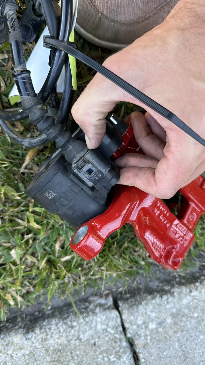

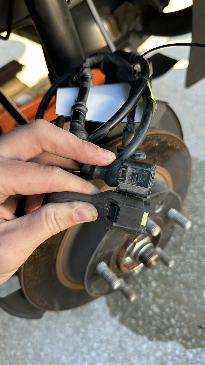

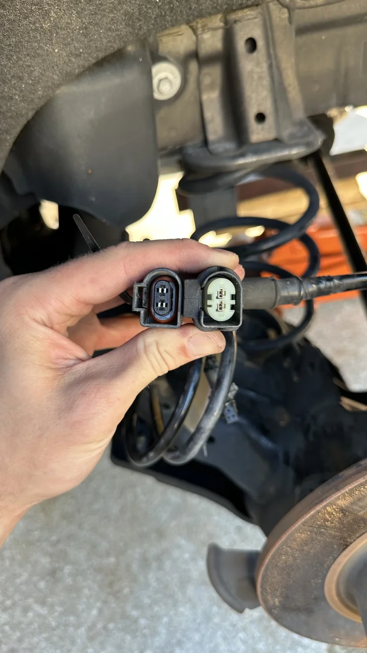

The 4th gen Mazda3's use the "D" shaped two pin connector like the CX-9's, but Mazda redesigned the sealing faces internal to the connector and it does not directly work.
CX-9 connector on the left:
CX-9 connector on top:
The 4th gen's EPB side is a bit taller/longer and no matter how hard you push the CX-9 connector on, it just won't latch:
However, the 4th Gen connector may easily fit over the CX-9 rear brake caliper. Please update if you find out!
