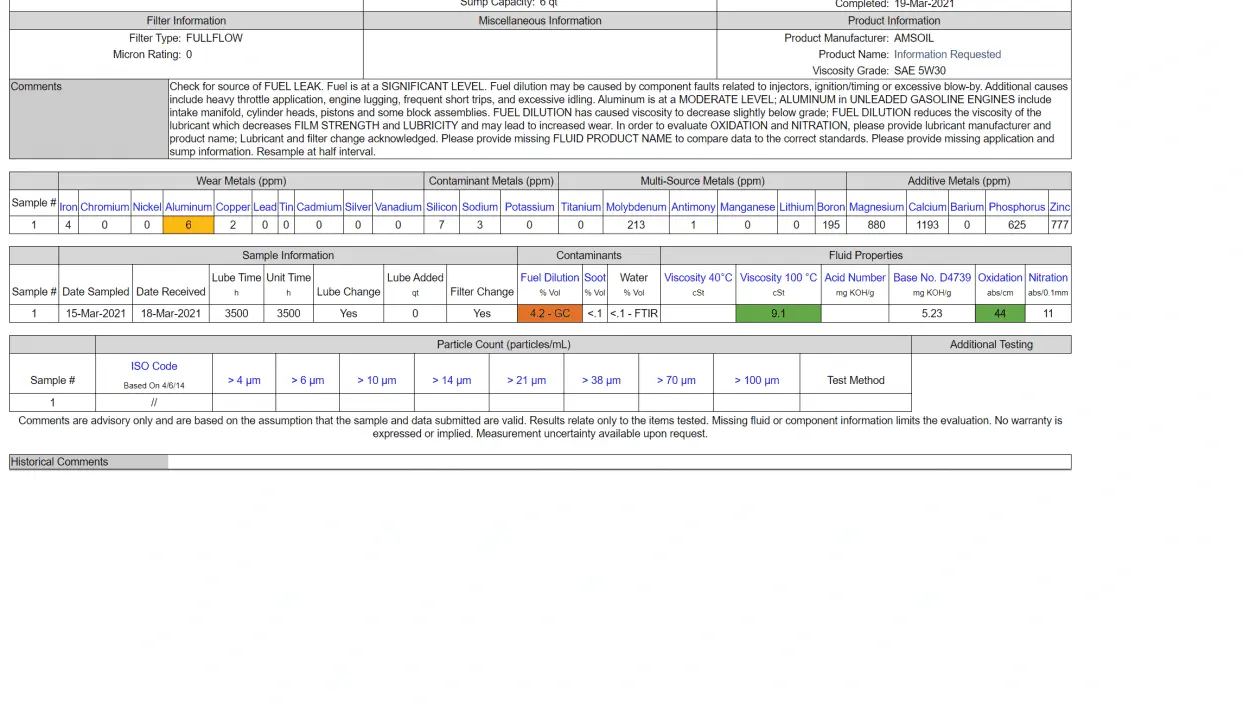

I've been changing my oil since I bought this car. Currently has 19k miles. During the early December oil change I noticed the oil that got on my gloves was separating. It was having trouble holding a film. I noted it and changed my oil two weeks ago at 3,500 miles and sent my oil to Oil Analyzers. They confirmed that I do in fact have an oil dilution issue. I use Amsoil Signature 5W-30 /w an OEM Mazda filter.
Anyone else have this issue? If so did you get it resolved or is this the curse of having a high boost engine? Anything I should ask them to do? I'm bringing it in on Thursday (3/25). I'm at least going to insist on a compression test and test the fuel injectors.
My report is attached. Thanks!
4.2% fuel on an oil serviced for a half of the recommended oil change interval at 3,500 miles is significant enough causing the oil viscosity below the 5W-30 grade slightly. My feeling is the engine has “behavior” change by itself but not from driving habit or environment, as you just noticed that the oil drained was different from many previous oils drained. This means your 2.5T has just started significant oil dilution issue not long ago before last December, and now the problem is confirmed by the UOA. You definitely should pursue the issue with Mazda and want to get the problem resolved soon under warranty.

Yes, but the oil tested had only been used for 3,500 miles and 3 months. And the viscosity is below the grade too, in addition to significant fuel content.

The only difference is that mine is a 2.5 T, it could be the boost is allowing for more blow by. It got me wondering if that's the reason Mazda specced 5W-30 for the turbo engines, they're expecting some dilution in the change interval. A change interval of 7,500 miles on an OEM speced synthetic oil is making me believe this is a known issues for the engine and they mitigate it by requiring a higher weight oil and a smaller interval. I'm not making excuses for them though and I'm bringing the car in tomorrow with the OA test report.
