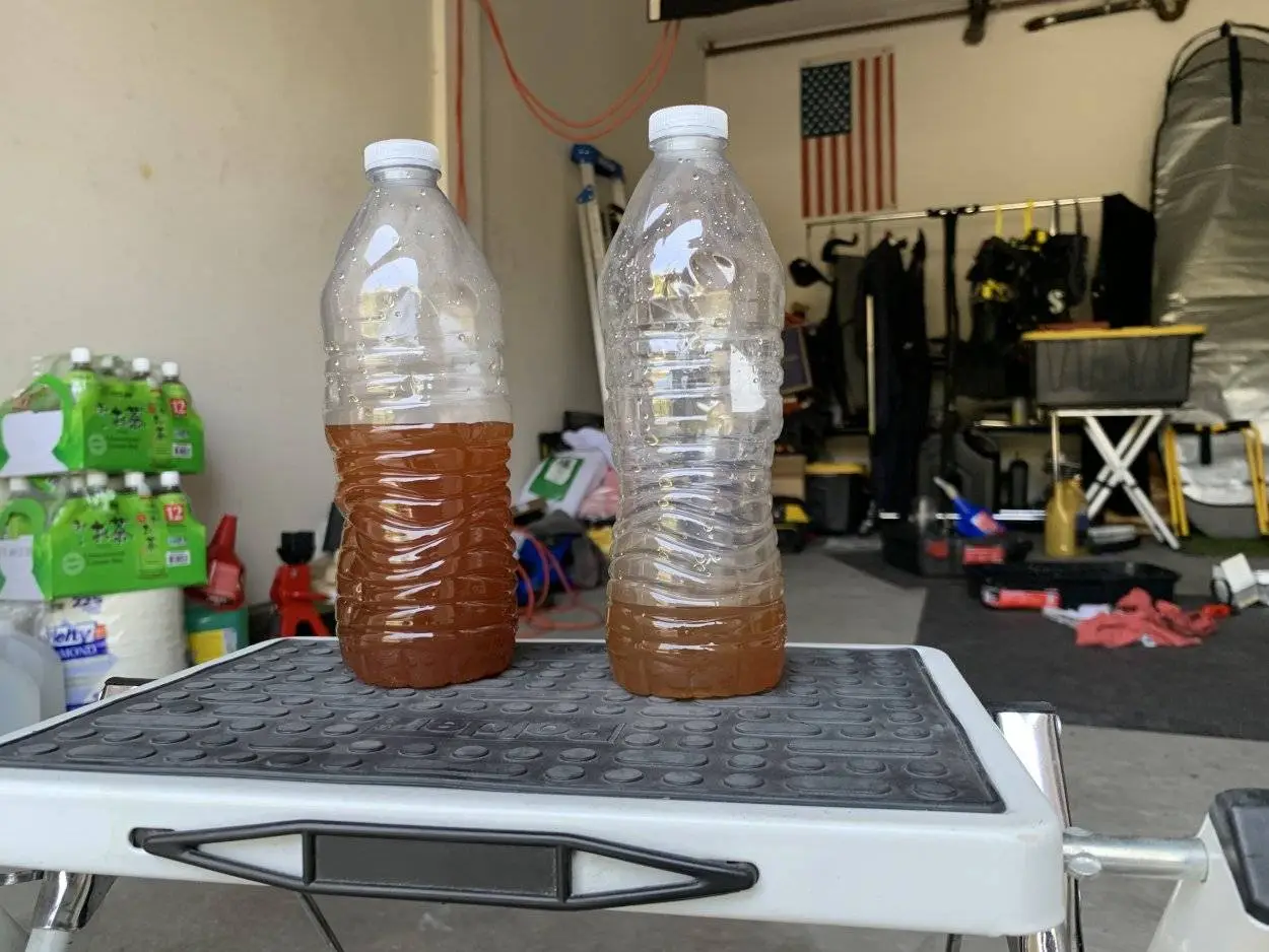

The RIGHT bottle was collected 500 miles after install.
The LEFT bottle was collected after another 3500 miles.
Highly recommend, especially for the 2.5 Turbo! Thanks @CorkSport

The amount of stuff which gets caught depends on the climate. During the winter I pick up more in my Mazda6 turbo as there is more moisture in the the air (around here anyways).
