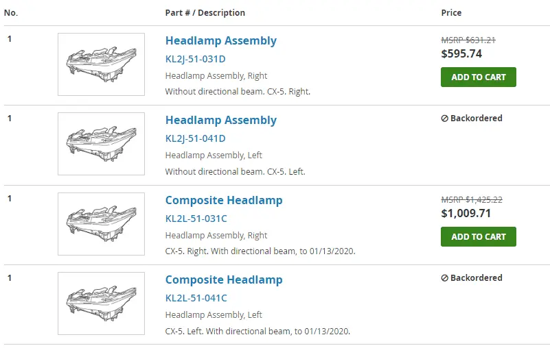

He could also go to junkyard. But most adaptive headlights are running around $700 to $1100 even at salvage yards.
Non-adaptives from $125 to $700.
Plus if he's tearing it apart with all the time involved if he can get a brand new aftermarket for $300, probably his best option.
Just needs to make sure he's getting adaptive if that's what's already in vehicle.
Look at Rock Auto. Some come certified as equal to OEM, at a price.
I have had a good experience with Auto Parts Fair, now Automotix.net. They are a network of salvage yards that disassemble and store parts. I bought a transmission from them that was strapped to a pallet and shelved. They ship, but I picked it up and they loaded it into my pickup gently. The whole thing came of as a quality operation. This yard was in south Atlanta. They are showing OEM Headlights listed on eBay, now.
I checked the mazdaswag.com.
For 2019 CX5.
It costs much more w/ directional beams.
These are new ones, not refurbished.
