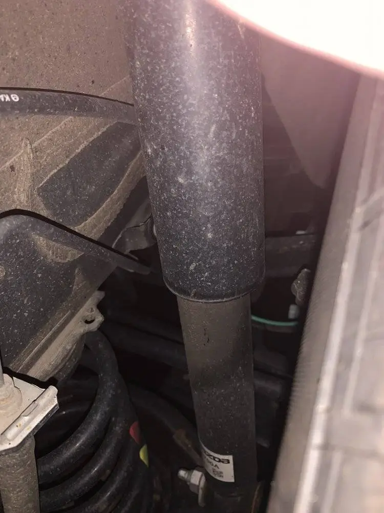

Update. It appears that the noise I've been putting up with since the vehicle had about 3K miles on it may be the rear shock dust shields rattling against the shocks. See the attached video clip. Now, to convince the dealer that this is an issue.
  • Dust Shield Rattle_Trim.mp4
    9.5 MB
Huh, how bout that. Could you put a bungee cord or shoe lace or something to hold them still and take it for a drive to prove your theory?
Thinking about trying a piece of foam or the like. Want to talk with the service manager before I try that though. Hate to see something get stuck up there if I hit a big bump in the road....
