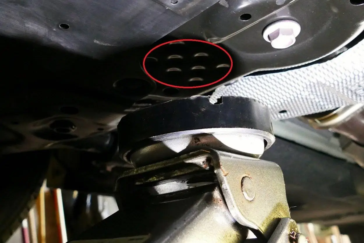

A hockey puck fits perfectly on the front jack point, it clears the plastic undercover and goes right on the dimpled strengthened metal. The rear I put the jack under the protruding metal thing that is bolted to the differential.
So this is the 2018 cx-5?
Also what about the rear? Some said the rear diff extension part that hangs down and others say between the two bolt holes?

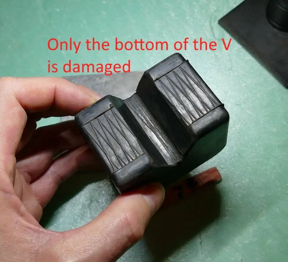

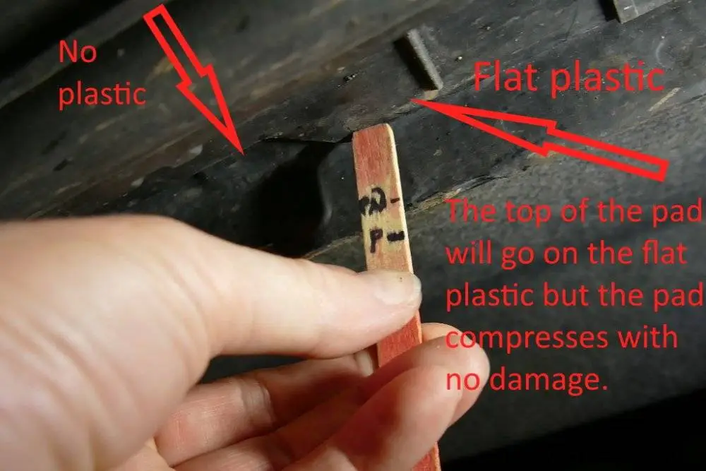

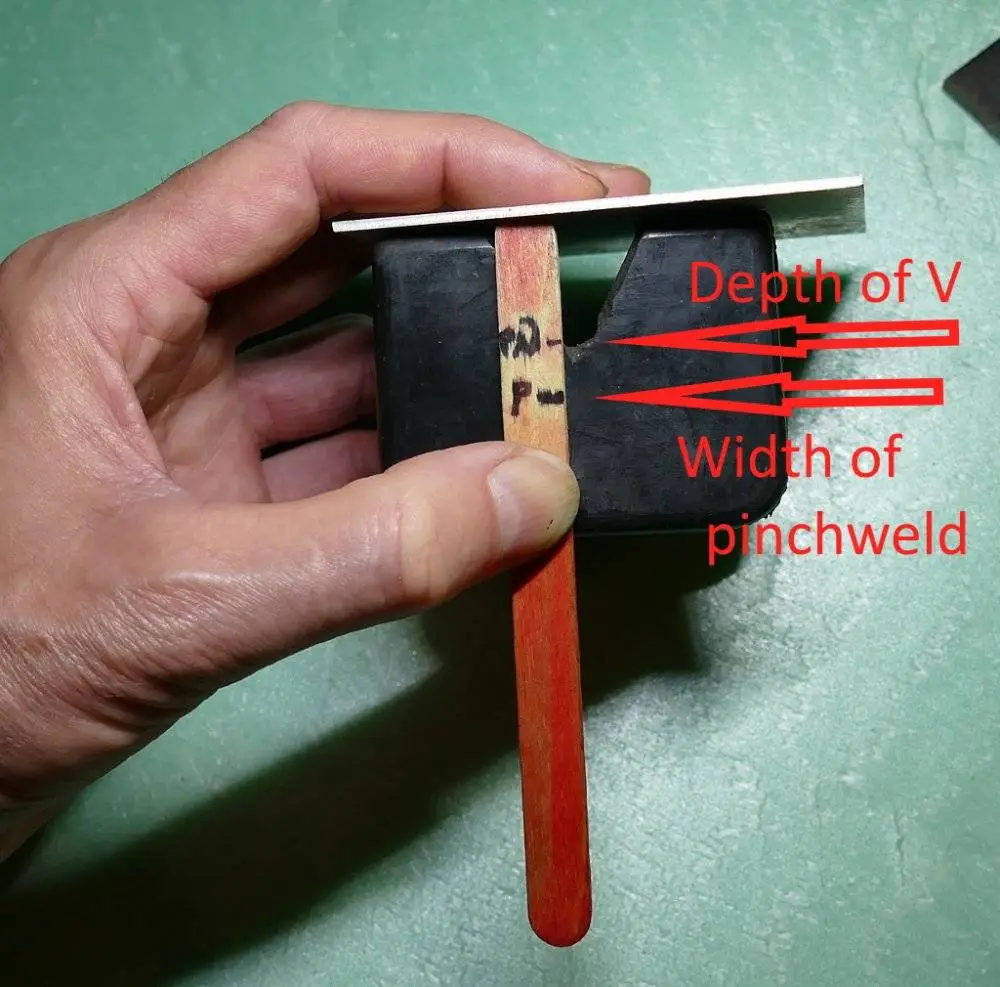

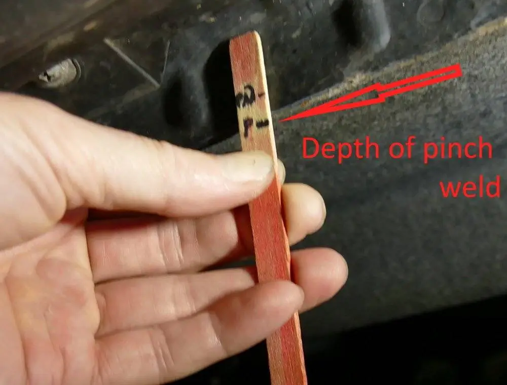

When you use those rubber pads for the stands, supposedly ONLY the top of the jack head rubber pads contact the vehicle's underbody w/o the RAIL contacting the bottom of the groove!
It is very important that the RAIL DOES NOT CARRY THE LOAD!
It is stated on the 2nd gen of the owners manual page 7-8 and it should apply to all vehicles with this type of STAMPED JACKING POINTS. Exception is if they are reinforced like in my 08 civic.
I made pictures that shows that the pads only get the weight from the pinch welds.
