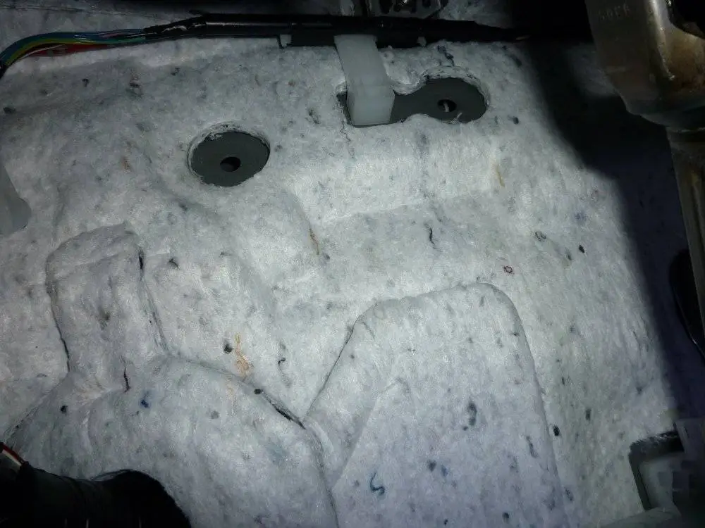

It's cold today here in the great white north and on the highway today I again felt a cold draft on the driver's side near my feet. This has happened many times in the past couple of years so today I decided to do something about it. Found two holes in the driver's side firewall above and slightly to the left of the brake pedal. Probed both holes and was able to put a length of coat hanger through the firewall in the hole nearest the brake pedal. I plugged both just to be safe and road tested the vehicle. Problem solved. Attached is a picture of the two holes. Looking at the picture the one on the right was the culprit. Hope this helps some folks.

Question: did you find those holes by looking under the dash or from the engine compartment?
Then, could you see the coat hanger on the, "other side???"
Couldn't see any thing from under the hood because it's too busy with equipment in the way. I found the holes by looking under the dash on the driver's side. I couldn't see the coat hanger on the other side of the firewall because of all the equipment attachments to and at the firewall. I knew it penetrated the firewall because I could feel it penetrate the firewall and hit something in the engine compartment. The brake booster and other equipment blocked my view from the top. May have been able to get a look at it by removing the lower engine cover and looking from the bottom but I was not that interested in going any further because I could easily tell that the problem was the hole closest to the brake pedal. The coat hanger bottomed out when I put it in the hole to the left but definitely went further and penetrated the firewall in the right hole. I'm just happy that I don't have that annoying cold air draft hitting my feet any more.

Perhaps not. I believe the holes in the firewall are for allowing the plastic grommets to attach the silencer/padding to the firewall and the one grommet has a hole through it which is not by design because the other does not have a hole through it. I believe you are reading too much into this. I don't regard plugging a hole that is not suppose to be present as a hack. Additionally the Mazda CX-5 does provide for outside air and there are instances where the manufacturer instructs us to use recirculation air. From the owner's manual "

Even with the climate control set to feet-only some heat is directed to the dash vents. I noticed today some of those vents were wide open from A/C season. After closing them all the heat to the feet was quite toasty in fact.

Well I've exhausted all suggestions and avenues for a cure. No success with the, "hole," under brake pedal. No real success with closing all the dash vents. SO..... I decided to take the question beyond the local dealer direct to whatever Mazda Support that Mazda Corporate has. Ha. Yes, there is a nicely presented website for corporate Mazda, but contacting them is another matter. They offer immediate, "chat." But all chat openings are busy.....always. They offer email contacts, but they have a written statement that due to heavy volume, that method is not available. Lastly, there is the telephone number.... - which I called repeatedly, mid morning, week days, from our Pacific time zone. After punching option 6 to speak to someone, I only got, "I'm sorry, our office is closed at this time." So how the devil does one ever get in touch with Mazda??????? At this point, I don't want to buy another Mazda. Oh, one last comment: someone suggested that, as I am an older person, perhaps I'm more vulnerable to being chilly. Well, I run at least 4 other vehicles here on our old farmstead, some over 20 years old with over 250K on the clock, and they have NEVER left me with cold legs, and still don't.

Well, Mazda (corporate I guess) opened a case or inquiry number for this. I took the car in to dealer two days ago. They kept it most of the day. When I picked it up they pulled up a short video of the mechanic, "showing," how he heat gun tested under the dash, both driver's side and passenger side, and it showed about 100-degrees. They then pronounced all was good. Suggested I run the temp higher in the car.
Drove home with chilly ankles. Nice and cozy waist up. Next I'll look again under brake pedal for the mysterious hole one poster found and plugged. Otherwise I think I've hit a dead end. If Mazda can't manufacture a heater that works well, I can't see ever buying another Mazda.

If the cold is more pronounced while driving, it's very likely that the draft is coming from the holes that OB1 mentioned above.
Now thinking about it, I only remember noticing this when driving. So I think you are right referring to OB!'s comment. I'm going after the, "hole theory," as soon as I can get my aging body jammed up under that dash.............
