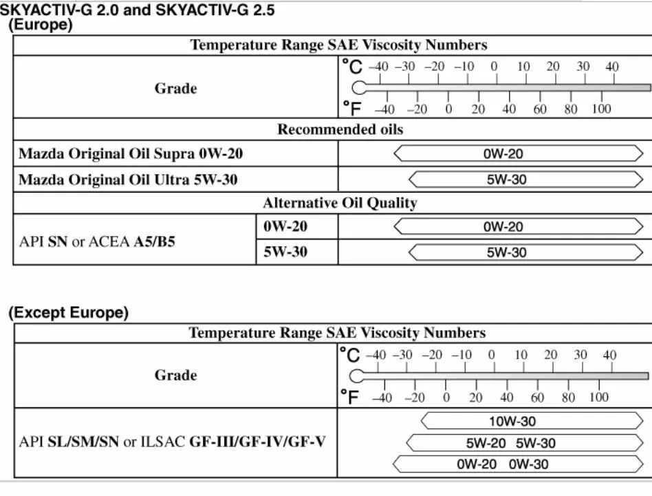

Mazda recommends 0W-20 oil for naturally aspirated 2.0L / 2.5L in the US, but more choices in other areas:
yep, that's the chart I saw. We don't see -40F, and not even 0F in North Texas. 100F, for months. 110F on occasion.
