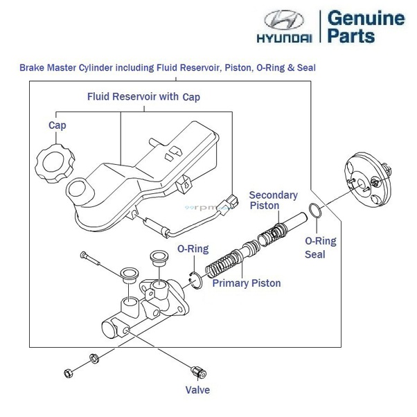

"The modern 4 wheel disc brake motor car has an anti-dive braking feature in most cases. They also have split systems to allow some braking to still occur when any single hydraulic line fails. The rear brake piston (primary) in the master cylinder moves past the fluid intake port and pushes until rigid, to operate the rear brakes. Then the front brake piston (secondary) pushes against a stronger spring that is stopped by the rigid primary cylinder in front of it, moves past the fluid inlet, then presses until rigid. So the rear brakes are applied first, then the front.
main-qimg-809c703050e8c8524726f819b86162ab
Yes there are design components such as limiters that adjust the rear pressure, but generally when lightly braking, the car does not dive down on every pedal push. Coming to rest judiciously allows the rear brakes to do the final full stop, which lets the passenger feel more comfortable by not being thrown forward and down. It is a real problem that the majority of drivers only know how to quickly jamb the brakes down to almost lock the front wheels every time they brake, and bypass this design feature. Cars with drum brakes at the rear will have a different set up to prevent the self servo action of the drum brakes from locking the rear wheels."
