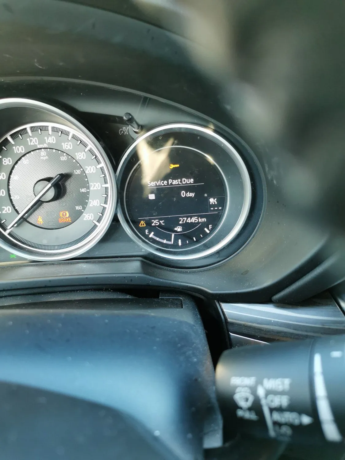

Pic of the error

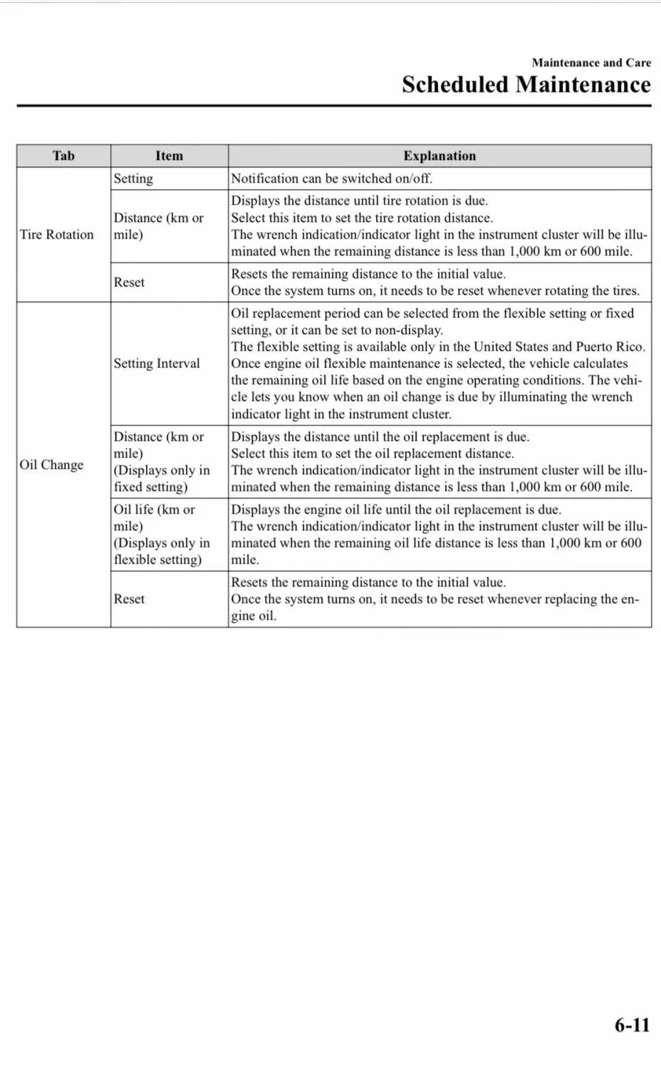

This “Service Past Due” notification is generated from “Scheduled” category by Maintenance Monitor. This has nothing to do with “Oil Change” part of Maintenance Monitor. See your owner’s manual for details to reset it.
There’s a TSB for those who can’t reset the oil change notification via Maintenance Monitor on infotainment screen:
