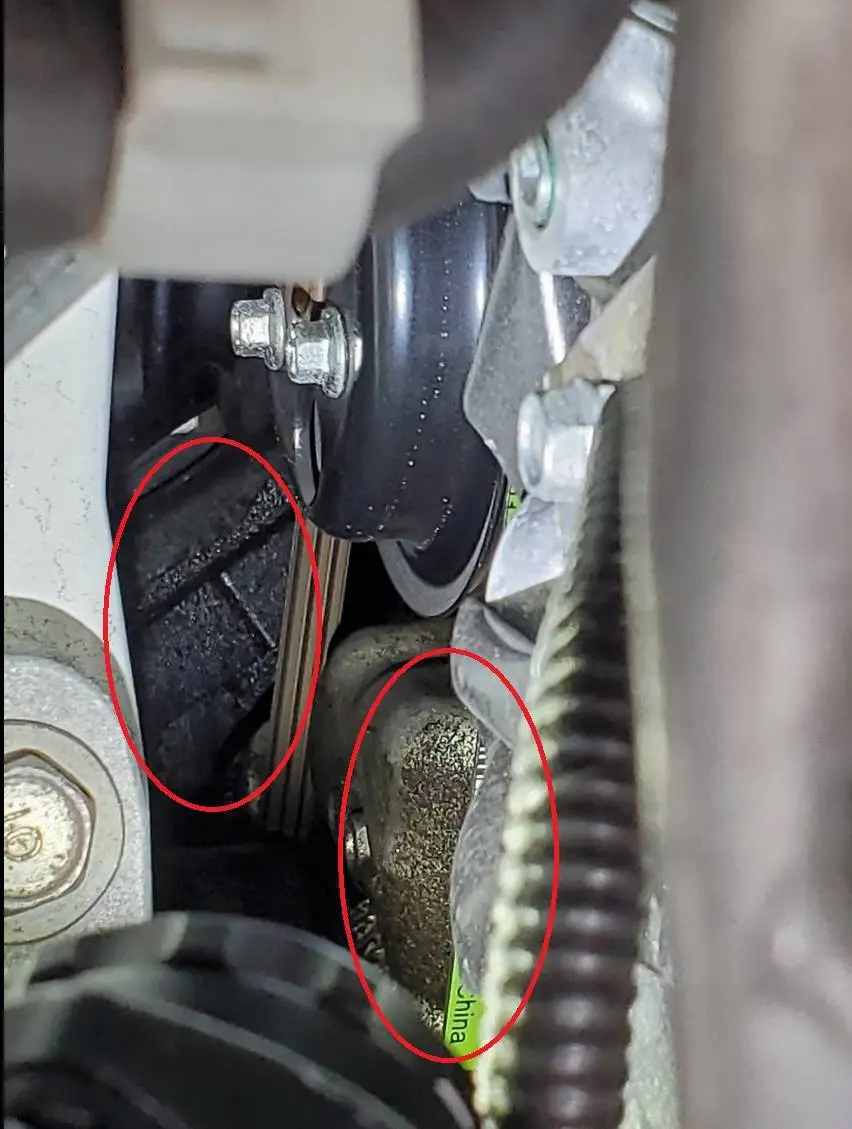

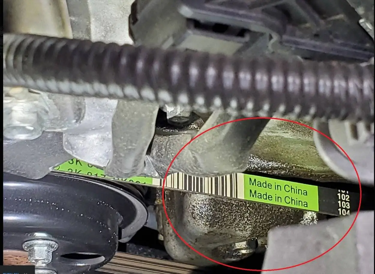

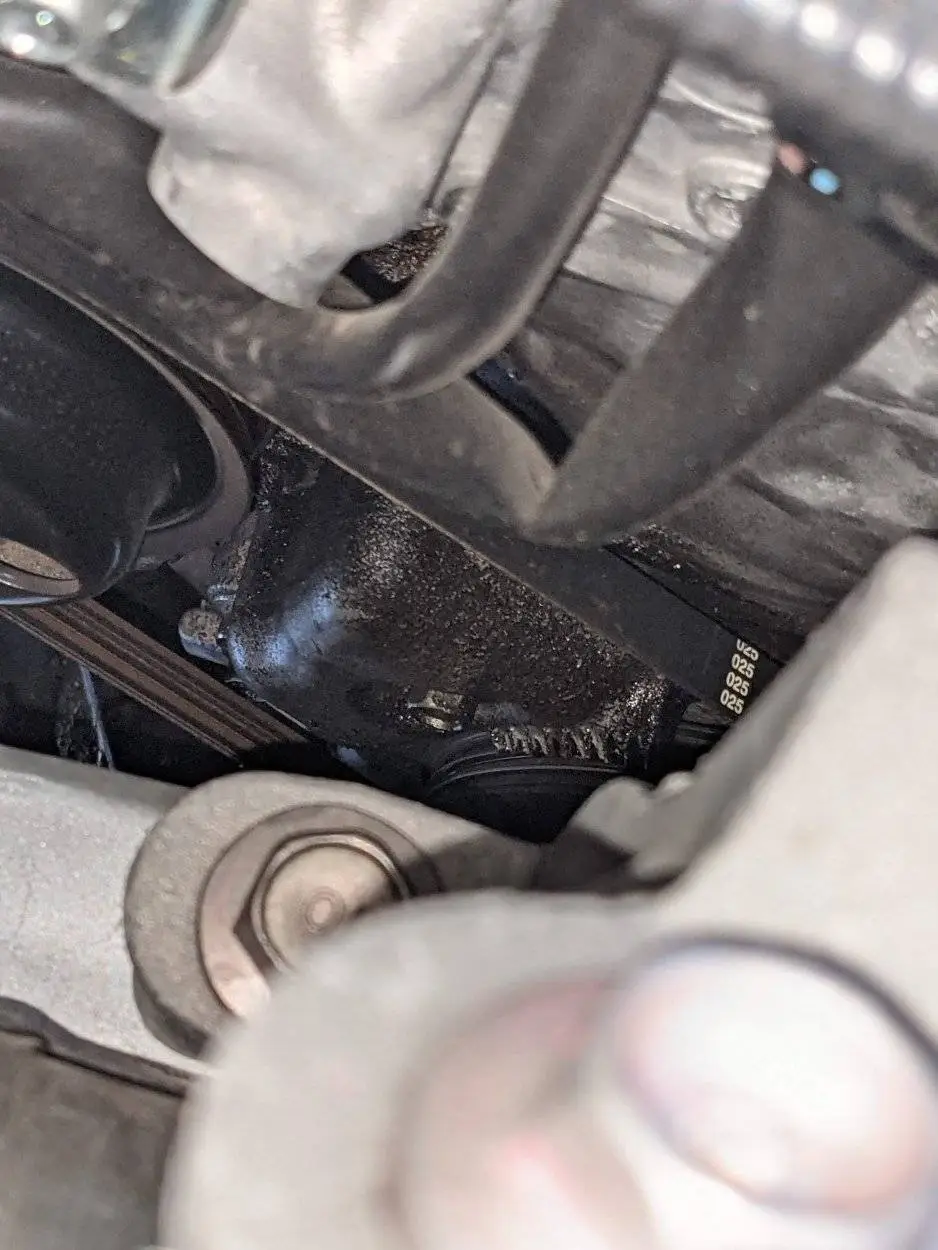

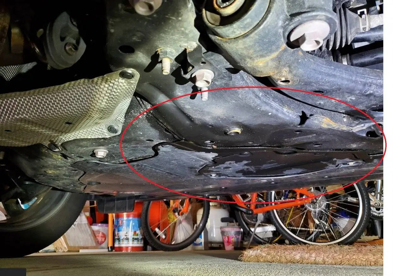

Sent my car to dealership to have them check oil leak (and referenced the tensioner oil leak issue TSB # 01-019/19. After a "thorough" inspection, they said they couldn't find any oil leaks but replaced the tensioner anyways. I tried not to roll my eyes and decided to send them pictures. Has anyone else had this issue?
From the TSB: "Some vehicles may exhibit oil leakage from the drive belt auto tensioner and rattling noises from the engine compartment. This may be caused by insufficient sealing at the drive belt auto tensioner damper when the auto tensioner fully operates under both high ambient temperature and high load conditions. To eliminate this concern, the shape of the drive belt auto tensioner damper has been changed.
Pics attached and one in line:

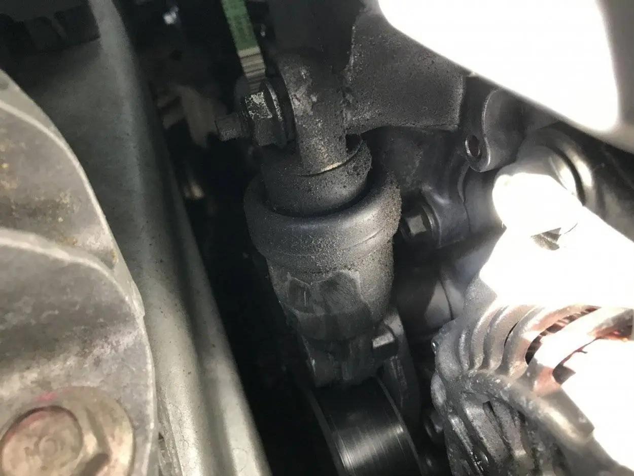

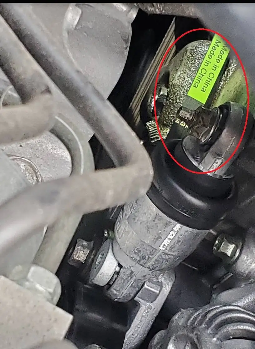

This leaky belt tensioner issue has been discussed many times here. It’s a very common problem for CX-5, and as you noticed, there’s a TSB for it. Here’s one long discussion for the problem:
Belt Tensioner - Shouldn't this be a warranty item?
And here’s what my leaky belt tensioner looks like on my 2016 CX-5 at 41,150 miles:
But there’s not much oil inside of the belt tensioner. A leaky belt tensioner can only make itself wet, but not capable of dripping much oil down like your pictures showed. Yours looks like having timing chain cover leak, which is another lesser common issue for CX-5 and there’s a TSB for it too.
Read up on the timing chain cover issue. Sounds like a real hassle to fix. I'm in a little disbelief that the master tech at the dealer said they didn't see any leaks today when they had it.
What do you all suggest? Try to get if fixed under warranty or let it go?

If I were you I’d definitely bring the TSB (although the timing chain cover leak TSB doesn’t include the 2018 CX-5) and ask for the oil leak repair if your 2018 CX-5 (how many miles BTW?) still has new-car warranty. Not saying the powertrain warranty won’t cover oil leak problem, but you’ll never know there may be some surprises or excuses by lesser powertrain warranty coverage. I’d try a different Mazda dealer with better reputation and reviews if that’s an option. I’d also contact Customer Experience Center, Mazda North American Operations sending the evidence of oil leak with pictures, and ask for help to fix the problem as the Mazda dealer you visited has failed to help.
TSB No.: 01-018/18 OIL SEEPAGE AT ENGINE FRONT COVER
On the second thought, you may not want to tell the dealer at front what the oil leak problem is coming from (such as you mentioned the belt tensioner, but apparently that’s not the culprit). Just say please fix the obvious oil leak problem, period.

With the amount of oil leaked based on the pictures shown, the leak definitely is not from belt tensioner, although his tensioner itself could have been leaking too otherwise the dealer wouldn’t replace it in the first place.
unfortunately most 2018 models suffer from both tensioner (not so bad) and chain cover leaks (worse). two separate issues. Sometimes the oil control valve too goes bust as well but that is on top of the engine.

Dealer confirmed timing chain cover leak. Stated they assumed the oil stains on the plastic shield was left from sloppy oil change :rolleyes:. Although they are friendly and have a convenient valet/loander program, I've needed to do a lot of the research / suggestions on my own. Otherwise, they just say everything is normal.
They are ordering parts. Need ~2 days once parts arrive to fix. Said they would drop the engine to do the repair. Yikes.

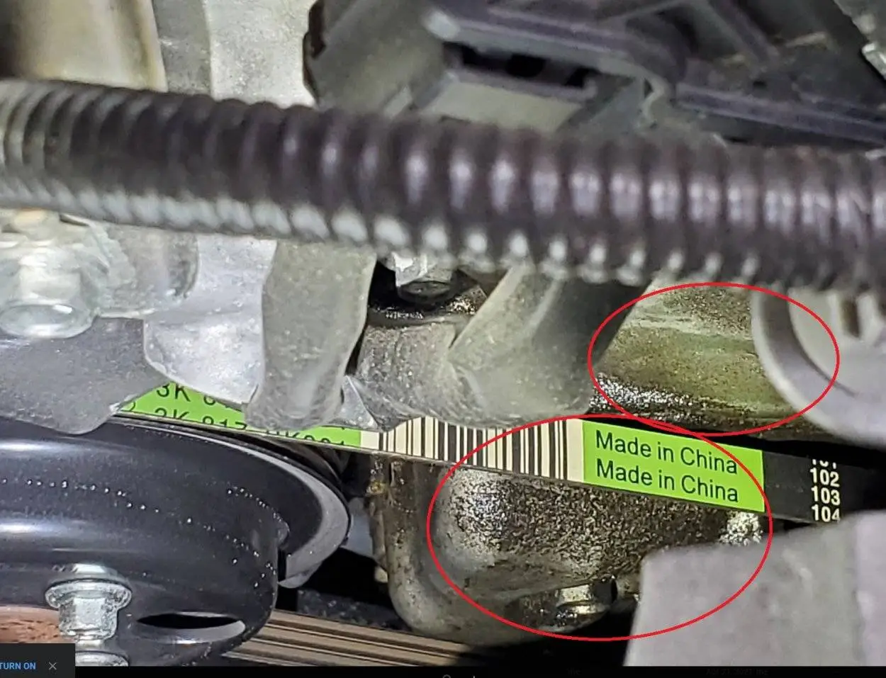

I just found a leak on my 2018 Sport today, I was hoping it was just the belt tensioner but upon closer inspection it looks identical to yours (pic attached).
There’s very thick and very minimum amount of oil inside of belt tensioner. The leak from tensioner usually will only be an oil film coated on the tensioner itself only. You won’t see any oil dripping to any other areas. Here’s what my leaky belt tensioner looks like on my 2016 CX-5 at 41,150 miles:
Make sure to show the TSB to your Mazda dealer when you take your 2018 CX-5 Sport in for timing chain cover leak.
