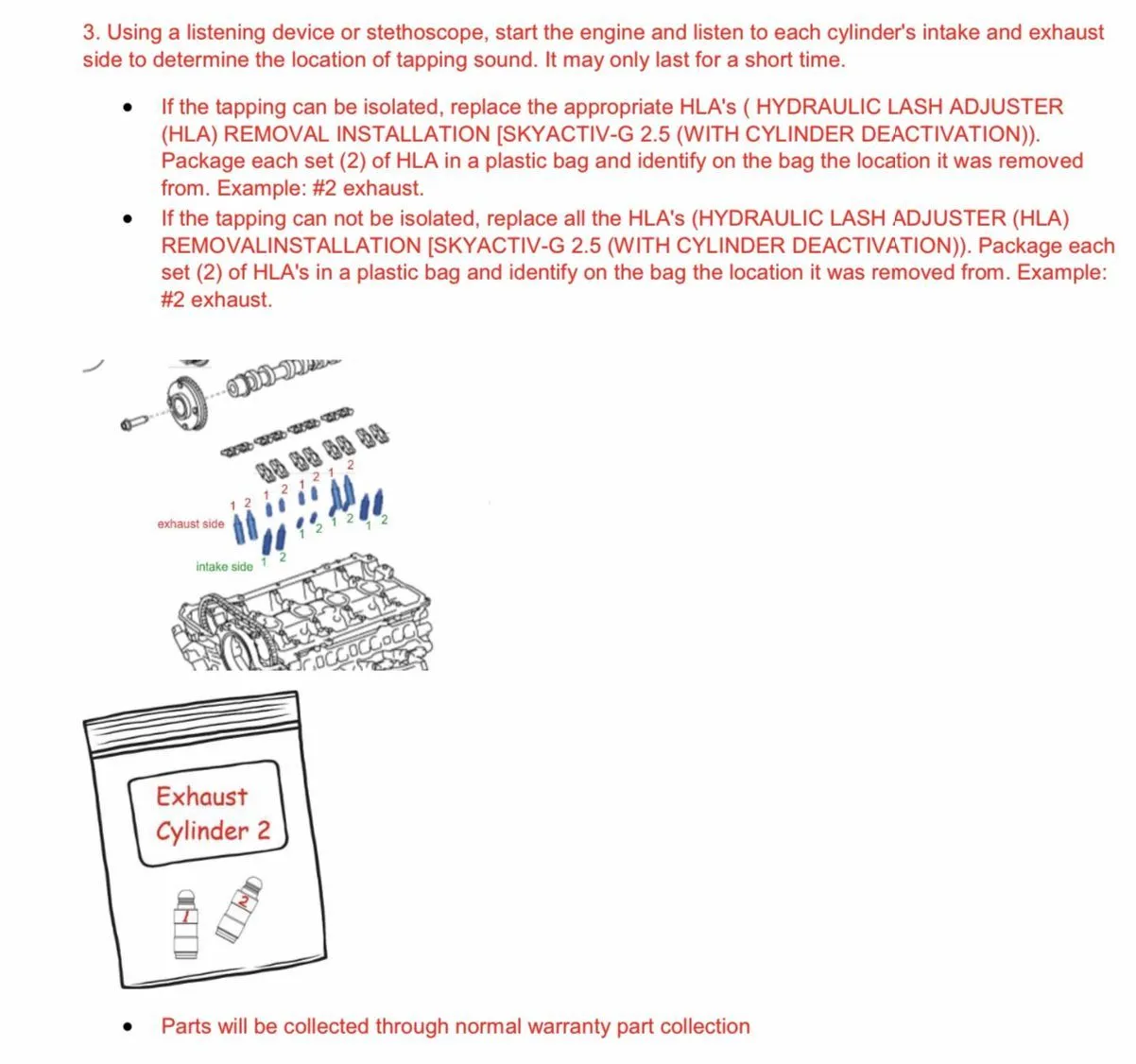

The HLA’s appear to be having issues. I think you will see a trend of more replacements happening regarding the service bulletin being circulated.
The 2018 does have cylinder deactivation but I don't think that ticking noise is from CD.
I thought in Canada 2019 was the year for CD, regardless I got feed up with the run around and non belief that the condition existed, even with videos! I traded it in for a CX5 2.5T, so lets see how this one performs.
Based on Mazda’s Service Alert and TSB, this tapping noise problem is only from 2.5L with cylinder deactivation on 2018 and newer CX-5’s. And the switchable hydraulic lash adjusters (HLA) on cylinder #1 and #4 are designed only for cylinder deactivation / activation.
But that other TSB you posted in the other thread describes the same symptoms as this one but is a year newer and applies to all 2018-2020 Mazda 6, CX5 and 2019-2020 Mazda 3s (even w/o CD)

and that is not the same noise that i am having to deal with that is a rapid clicking noise . The metal on metal tapping noise I have is a completely different animal and is occurring on the top passenger side of the engine right under the top cover no wheres near the HP fuel pump. As I have posted , the mazda technician has already identfied it as failing Hydraulic Lash Adjusters and i am scheduled to have mine replaced. That timing retard diaspears quickly once the cats heat up but the metal on metal sound is more prominent and doesnt go away until the engine fully heats up after about 15 mins

Show the Service Alert to the dealer, and contact Mazda North American Operations or Mazda Canada complaining.
