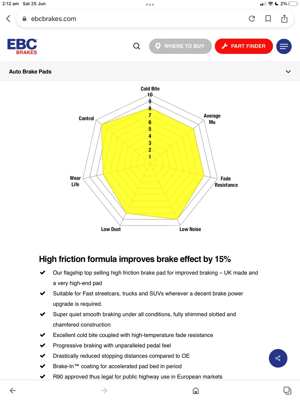

No the color is based on the type pad... Green stuff -semi-metallic, red stuff - ceramic low dust, yellow stuff- aramid fiber high dust great stop power...
Yellow will work the best but are dirty... Reds are ceramic low noise low dust.

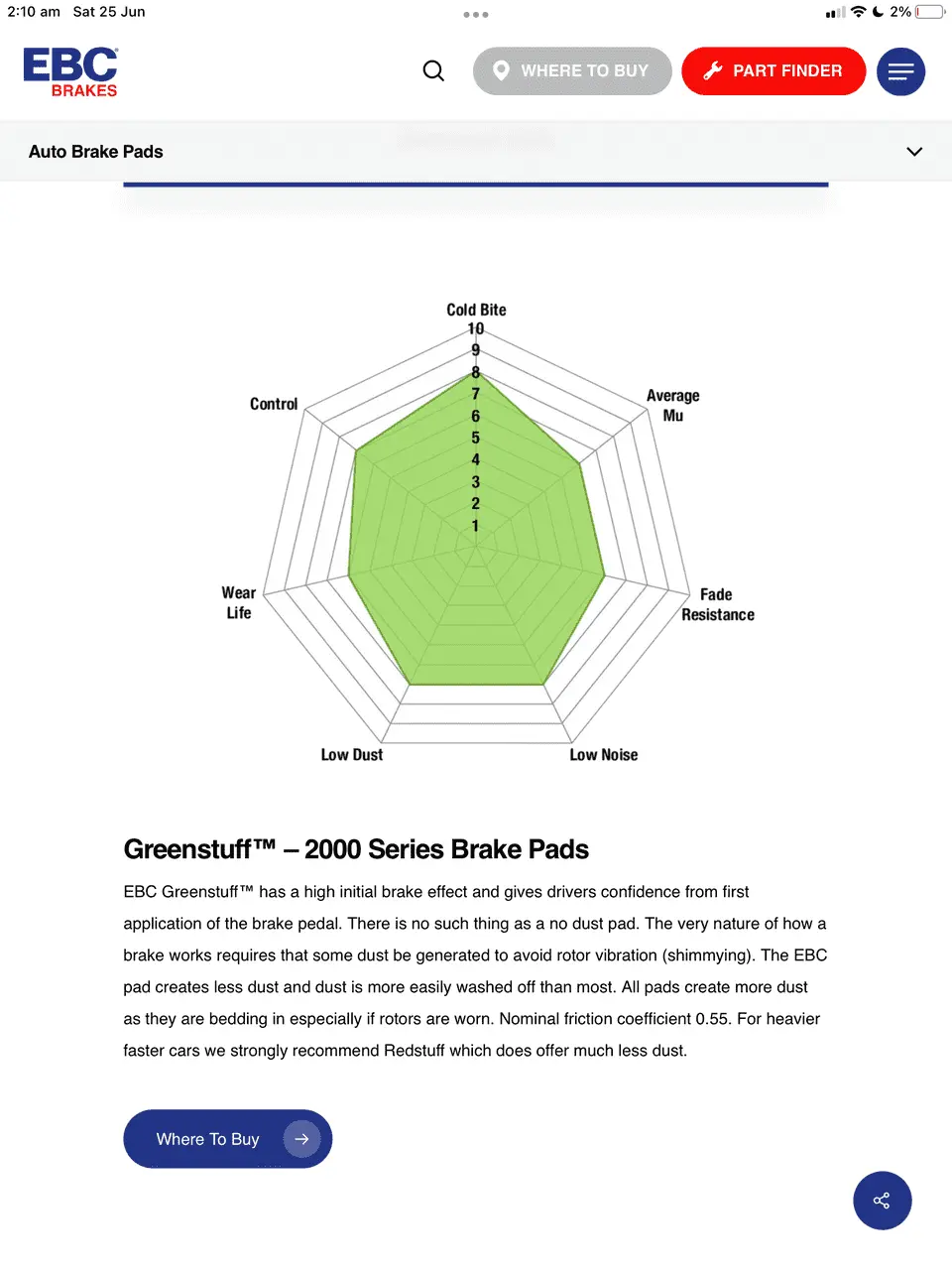

EBC Redstuff have the lowest dust, but need a little warmth to be at their best for city driving.
