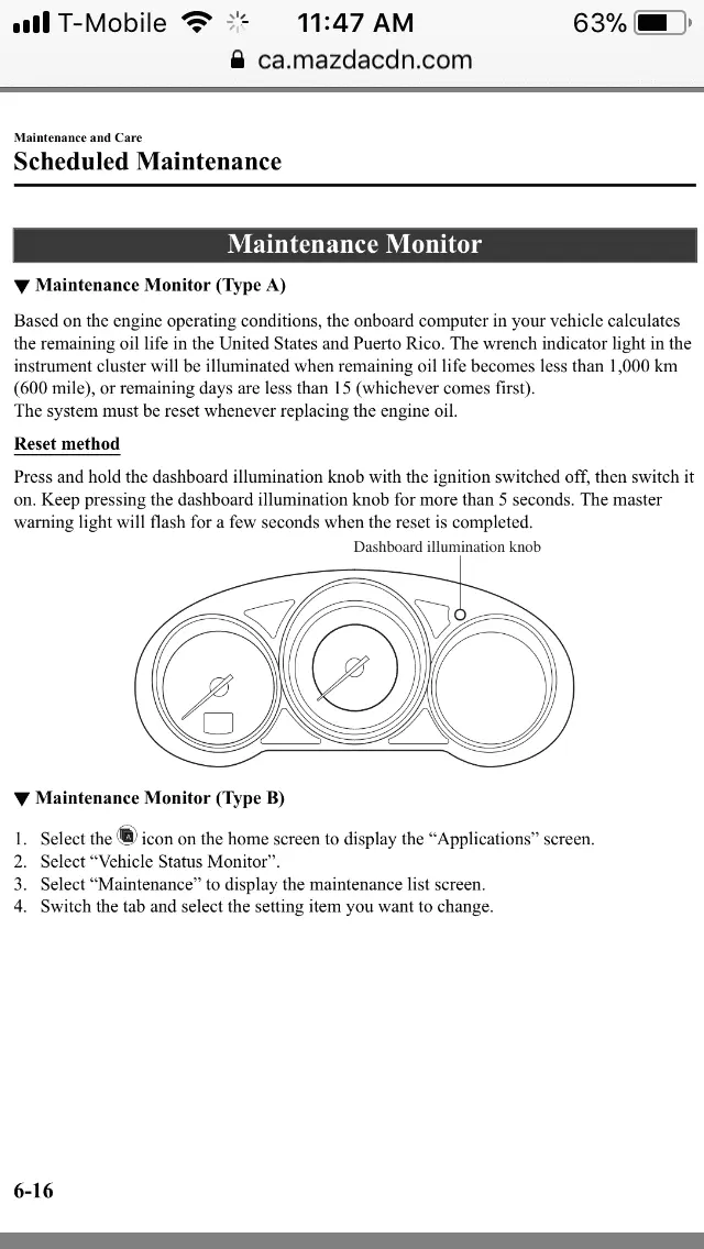

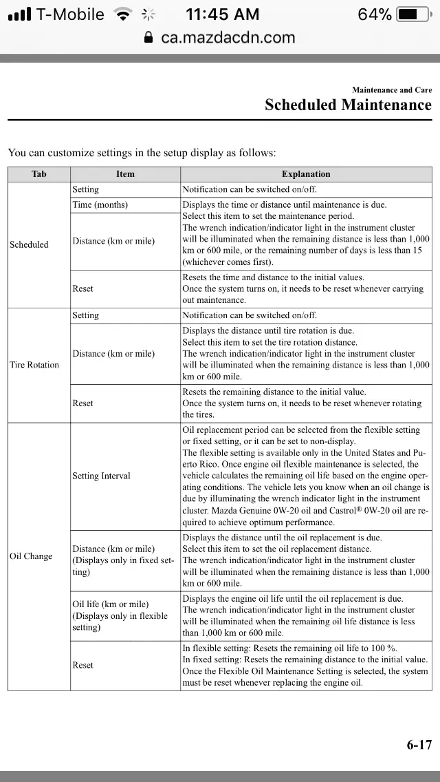

You have a GT and you have Type B Maintenance Monitor. You should follow the instruction of your owner’s manual. First you turn the ignition on without engine running. From infotainment home screen you select “Applications”、”Vehicle Status Monitor”、”Maintenance” and choose the “Reset” under “Oil Change” tab. Using dash illumination knob to reset your maintenance monitor is not for your CX-5 GT.
Also remember you have 3 maintenance items which will trigger the wrench indicator. Make sure to reset all three with proper settings either with Flexible, or with time and distance.

Thank you for your help yrwei52. I reset the maintenance interval in the infotainment with the engine OFF and it seems to have worked....though I want to wait a day or two to make sure. I thought I resoved the problem once or twice since yeaterday but the warning seemed to return. I have to point out that NOWHERE in the manual under Monitor type B does it say that the engine should be OFF. As stated...I had done so with the engine ON and that seems to be why it didn't work.
Puyapim, I agree that generally the owners manual is wealth of information but in this case it seems to be lacking.

You can easily go to Maintenance Monitor mentioned previously to check status of these 3 maintenance items and see if any of these 3 has past due. If not, you should bring it to Mazda dealer at your earliest convenience to fix the problem.

Sorry to hear that! When wrench indicator came up, what message did you see with wrench indicator? Was it Oil change due、Scheduled maintenance due、Tire rotation due, or something else?
Since Mazda uses Flexible oil change schedule as the default from factory since 2017 MY, many CX-5 now should reach or pass the first oil change. As the system has also changed a bit since then by using miles instead of percentage to show the remaining oil life, I got feeling that your PCM firmware which is doing the calculation may have bugs too. In my situation, the 2016 CX-5 is the first to offer Flexible oil change maintenance monitor but the default from factory is Fixed OCI. I was one of the few switched to Flexible OCI at beginning and soon I found out therere problems very similar to yours. The wrench indicator with Oil change due message was displayed even though there was 30% of oil life left. I changed the oil and did the reset, but the wrench indicator with Oil change due kept coming back! Not until Kedis82ZE8 who was very helpful finding me a TSB related to Flexible Maintenance Monitor and I took it to my Mazda dealer and have them updated the PCM firmware and fixed the problem.
Theres another thread related to Maintenance Monitor. Once he did the first oil change this weekend, itd be interesting to see if hes going to have trouble to reset the Flexible oil change monitor.
'Oil change due' vs. 'Service Due'
In my case the indicator says "service due"....but I had the service indicator off. I was only using the tire rotation and oil change reminder in flexible setting. Now I'm wondering if I even needed to do the oil change. I just assumed when I saw the wrench it was for the oil change. I didn't realize the "service due" was a separate warning. Adding to the confusion, the warning doesnt come up every time you start the car. It can be fine for a few days and then reappear. Last night in order to try and fix it i enabled the "service" reminder....reset it....then turned it off again. I also re-re-re-re-re reset the oil life monitor for good measure. Does anyone know for sure if there is a TSB for the OLM for the 2017 CX-5's? I dont want to leave the car with the dealer all day only to fin out they have less of a clue than we do here. I may just turn it all off and go back to manual record keeping! I sent an oil sample to Blackstone. I dont plan to do so all the time but wanted to know how the oil looks after 9 months and 5600 miles. That will give me an indicator of how far I can push it.
