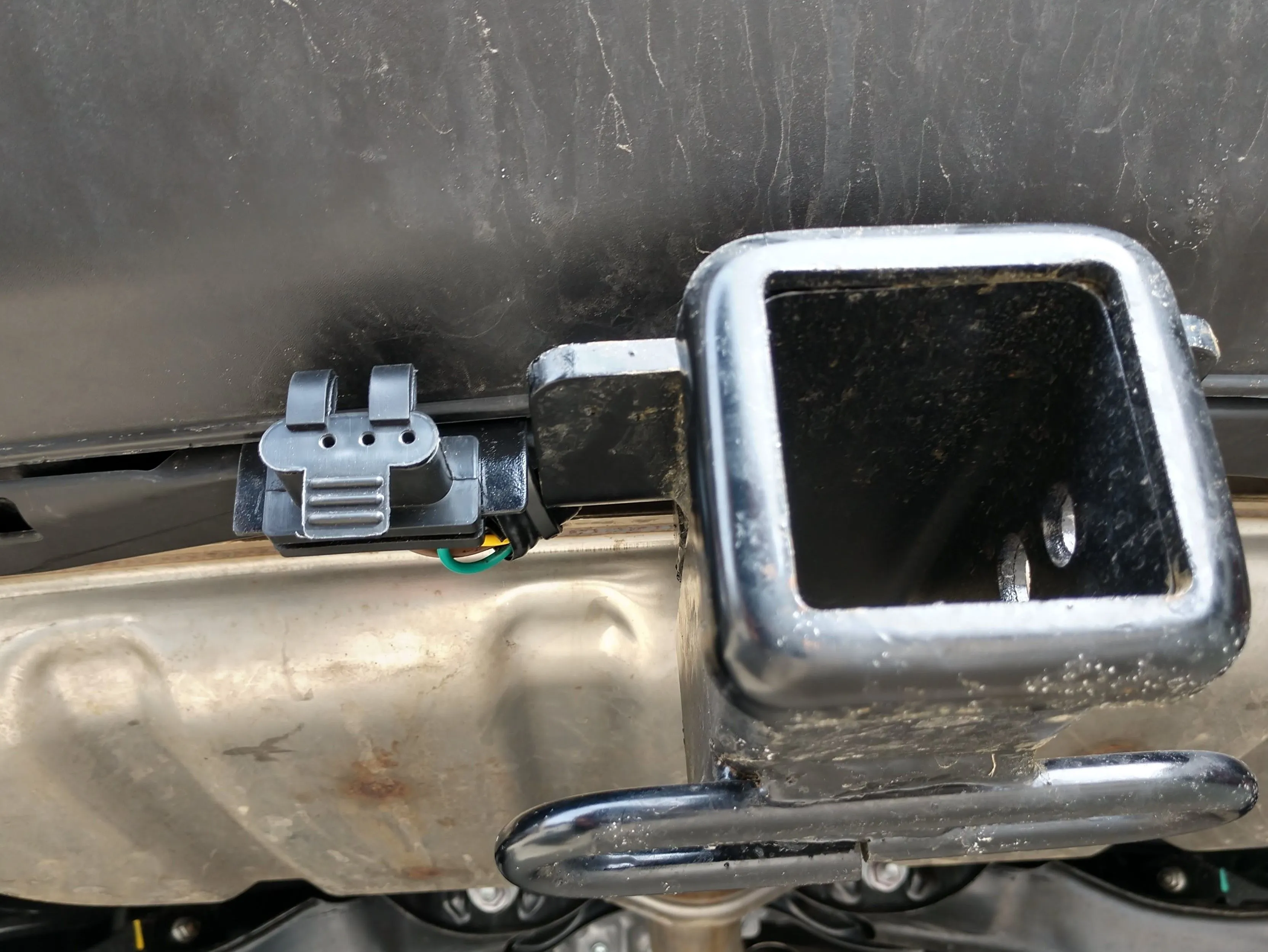

I did mine the same way, but on the floor. yes, very easy. The harness is easy too. the only thing to watch for is there are 2 pink wires in the harness - there is a picture showing which one to tap into (not sure it matters) Otherwise it was not hard. I made a custom bracket to hold the 4 wire plug - 16 gauge metal and attacked it to the drawtite hitch with a hose clamp - similar to how a generic etrailer bracket works. HItch.webp

No, there is a rubber plug in drivers side wiring harness area and it drops through there. The OEM kit comes with the 4 wires without the plastic male connector on one end. You pass them through the hole where the rubber plugs was, slip the grommet on, then pop the 4 wires into the plastic plug (metal connectors already on wires) then you just push that plastic male plug into the female plug on the module.
The biggest warning in the docs is to keep the wire away from the muffler (5cm min) I was able to route my wire on the rear side of the hitch - between the bumper and the hitch. The OEM hitch is designed differently. It tucks up higher and it looks like they had to pick a different wiring path.
