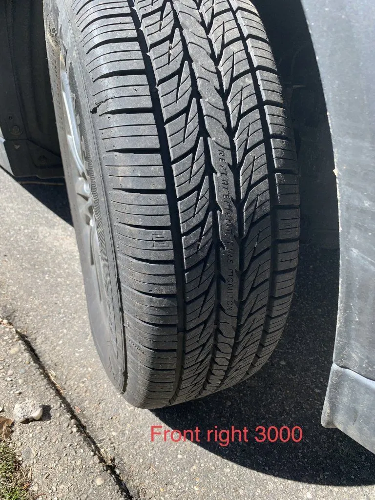

Just wanted to report to everyone that the creaking is still present, as before. Also, at 3,000 miles on the tires I've noticed the fronts are wearing out faster than the rear. It's AWD so my understanding is that this is normal due to braking and turning forces placed on the tires, and I'm assuming the CX-5 is mostly FWD under normal operation? More concerning however is a heel-toe wear I've noticed. As seen in the photo (more pronounced than in person due to the shadows), the front of the tread blocks are higher and sharper than those on the rear tread block. In other words, the tread is sloping down from front to rear. Wonder if there's a correlation.

Front tires always wear faster than the rears because they do the steering. That's why most people rotate them every 5 or 10K miles. If your tires are not wearing evenly you should get an alignment.
