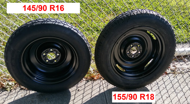

...........I thought Mazda made a mistake from factory putting wrong spare for FWD into my AWD CX-5 which was special-ordered and picked it up immediately once it got trucked into our dealer's lot. But as stated in our owner's manual, later I verified all CX-5's, FWD and AWD, are getting T145/90D16 106M smaller-diameter temporary spare with 60 psi air pressure.............
Yep, confirming what Yrwei52 said, I just checked and I'm surprised to see the small 26.3" diameter T145/90 R16 spare
in my '16 CX-5 AWD GT with 19" wheels. i chock this up as another Mazda penny pinching with disregard to customers' cost of future repairs.
I have owned AWD in the past and it's extremely important for AWD systems to have all the same diameter wheels, mismatched wheels will cause stress on the transfer case and cause premature failure......

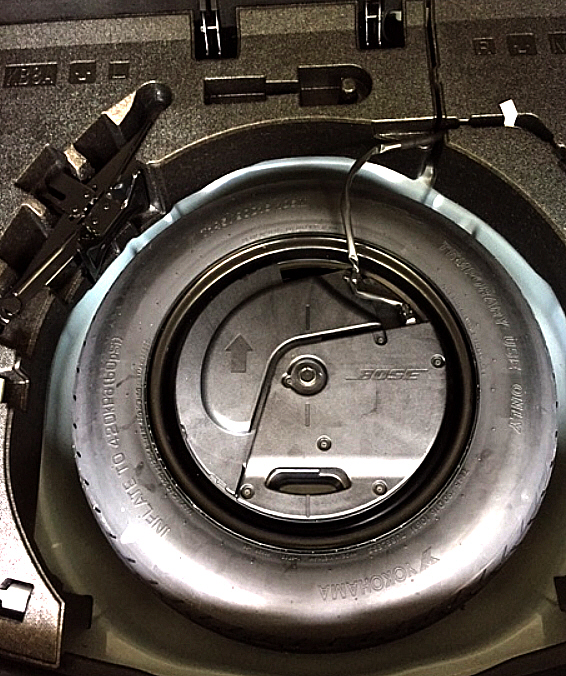

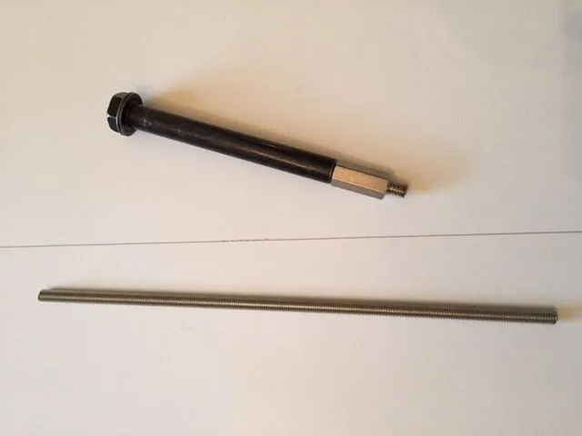

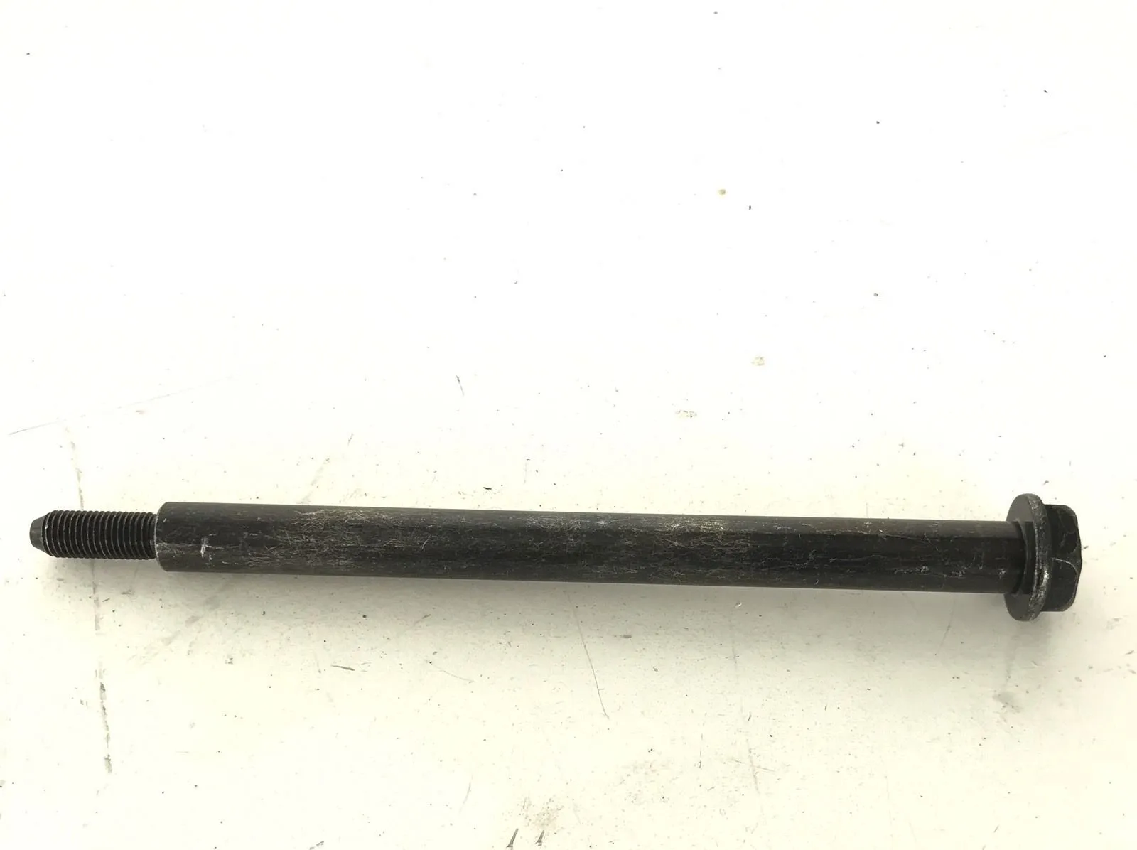

On another note, if you have the bose subwoofer, there is a hold down bolt that goes through the center of the unit that sits on top of the spare and holds both the speaker and the spare in place. It looks like this (sorry for the huge pic):
attachment.php
With the wider 17" steel wheel, the bolt is not long enough and will barely grab any threads if you can get it to grab at all. I lengthened the threads with a coupling nut and some threaded rod. Size you need is M8 X 1.25. You can cut a piece of the threaded rod to the length you will need, but you will have to experiment to get the right length and probably need to file the cut ends a little. Once you have it, use some blue loctite and let it sit overnight to set up and you should be good to go. If you make it a little long, you can use some washers between the bolt head and the bose speaker to make up some room. I used a couple of hose washers and it works great.
attachment.php
Bigtex, in the pic above of your "new" bolt, is that the final length? If so, what is the length? It looks about an inch longer than the stock bolt.
It is about 6 3/4". The coupling nut is about 1 1/4" and it would be better if you could find one a little shorter, but then you might need to snip some of the threads from the original bolt to make room for the new threaded rod. If any of that make sense?
On my setup, the coupling nut hits before the bolt is fully tightened, so I just used a few rubber hose washers between the bolt head and the speaker and then when I tighten everything up, it is very snug against the speaker.
Greetings. New to the forum and plan on getting a CX-5 Diesel when it comes out. I currently drive a VW TDI, so the VWGate issue is dropping a large pile of cash in my lap for me to switch over.
I have a background in machining and welding from the Army, and I would have chosen a different route. Ideally, I would cut the bolt and lengthen it to the needed size and weld it to length.
But another method I would choose is to cut off the threaded portion of the bolt. Then drill and tap the solid portion and insert the threaded rod into your new hole with additional length. To adjust bottoming length, you can just add a nut to the end, which can give you a smaller incremental length increase without needing to add washers to the top. This would require a little more technical how-to, but I think would be better in the long run.
But I do appreciate you finding this information. I go scuba diving as often as I can and I have some heavy steel tanks I carry. They've cause issues with my TDI, but using the spare tire as reinforcement for their weight would help out a lot.
Sounds like a great way to do it as well! I was just using readily available parts and trying to provide a quick, easy fix for those without welding equipment or a drill press. The CX5 diesel should be awesome.

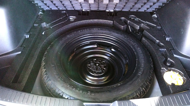

I found a Dunlop Space Miser T155/90D18 113M tire off a wrecked '14 1st gen CX-9 at a local junk yard, the spare was practically brand new never used, junkyard wanted $65, I thought it was a good deal, so I bought it..... it fits perfectly in my 16 CX-5, no need to take off or cut the foam smaller, fully plug and play mod....
Bigtex is right, when you see it in person, the size difference is startling, I can't believe Mazda approved this, the 145/90 R16 would not be good for the AWD system

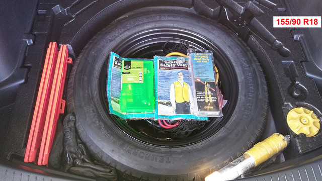

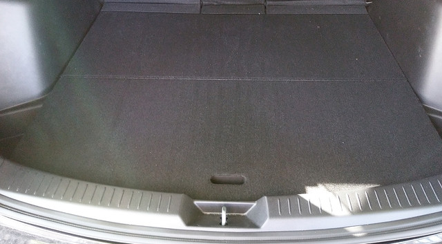

155/90 R18 fits perfectly in 2016 CX-5
cargo floor is flat without any modification, just drop in new wheel and screw on, pure plug and play
the larger wheel now takes up the empty space where I used to put my heavy duty emergency orange triangles, and with cargo space at a premium, I didn't want the triangles up in the cargo area, I wanted them to remain in the hidden spare tire compartment, so I cut a little of the foam to the left of the spare, that extra foam was useless and doing nothing and just taking up precious space. Now everything fits nice and neatly and ready for any emergency.
