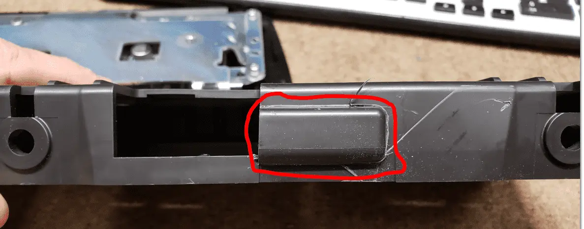

I pulled the ribbon cable last night for the touch interface. 30 min start to finish. Unlike one of the YouTube videos, I took the back cover off the LCD panel, and neatly cut away, with a utility knife, that raised plastic section covering the ribbon, vs chewing it away with needle nose.

Yep, just have to dissemble the touchscreen cover further to get at the connector.
